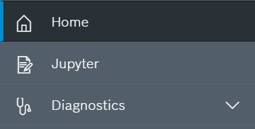

STEP0: install the app
Once installed the Jupyter app will be present on the left sidebar.
Jupyter Sidebar

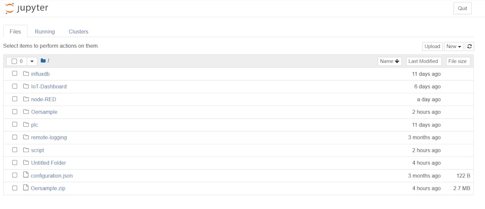

Once we click on the Jupyter icon the app opens up. We can modify the content of the active directory and upload here our files.
Jupyter code

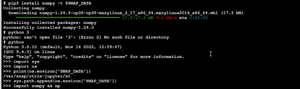

STEP1: Install and use libraries
To install and use PIP downloadable libraries is very simple! First we need to open a new terminal and decide where to install the libraries. The command we need to run is:
pip3 install LIBRARY -t LOCATION
The library is then downloaded and installed in the chosen directory, it is suggested to use:

For the first and second method we can direclty run the installation command!
Install PIP packages

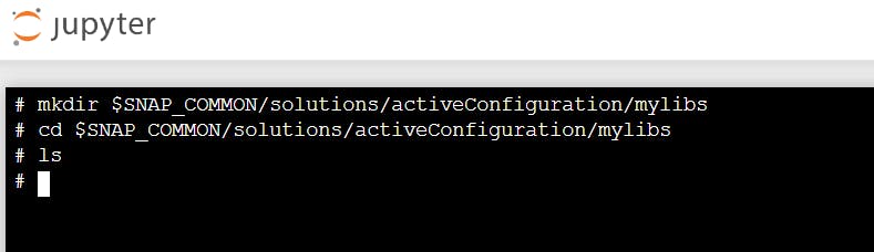

For the last method we need to create the library first, how? We open up a terminal and we run the following command, taking in account thet we want to create a folder that is called "mylibs".
mkdir $SNAP_COMMON/solutions/activeConfiguration/mylibs
create Folder

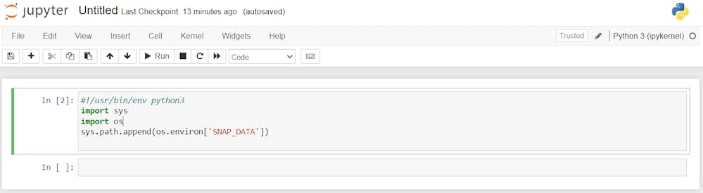

Once the right libraries are there, we can create our Notebook. We need to add the created folder to the python folders in order to be able to use the libraries!
use folder
If we used the last method our code should look like this:

STEP2: Upload zip files
The app is equipped with the unzip packet. we can upload a file and the use the unzip command to unzip the archive in the local folder!
