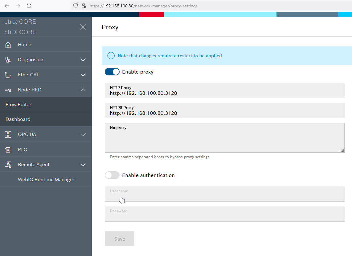

I'm trying to install node-red-node-email in the Node-Red for ctrlX.
But there is always an error. The protocol is down below.

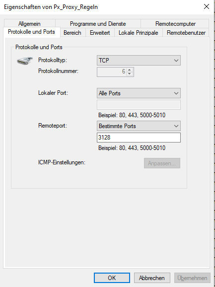

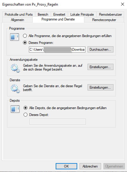

I also tried to run the px.exe, set up the firewall entrance rules and restart the ctrlX. But the error still scours.
Attached the screenshots of the Settings.

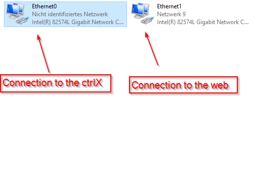

The browser is running on a vMware and connected in a local network with the ctrlX. The vMWare have also a connection to the internet.

Did you set up your proxy properly to listen to your request IP?
Is the proxy running in your virtual operating system?
