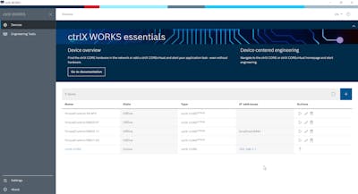

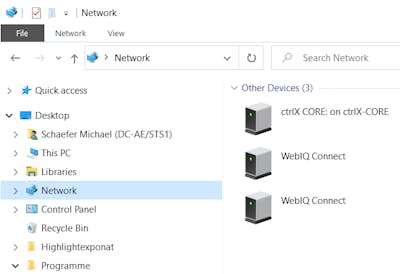

Even when you don't know the IP of the control it should be visible in the Windows Network folder
and also in the ctrlX WORKS.
