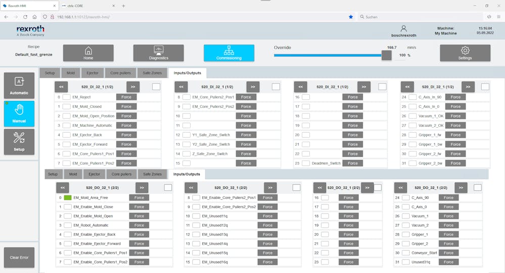

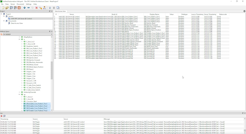

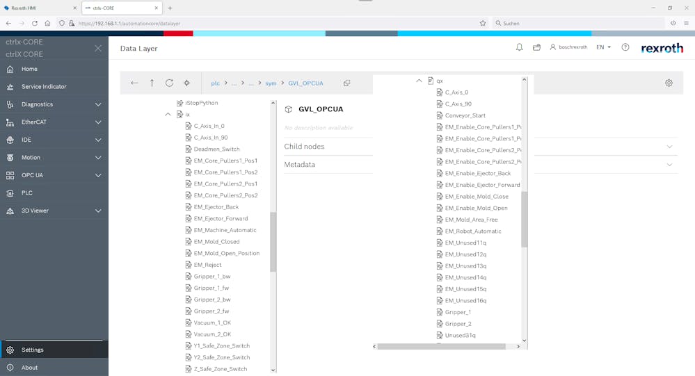

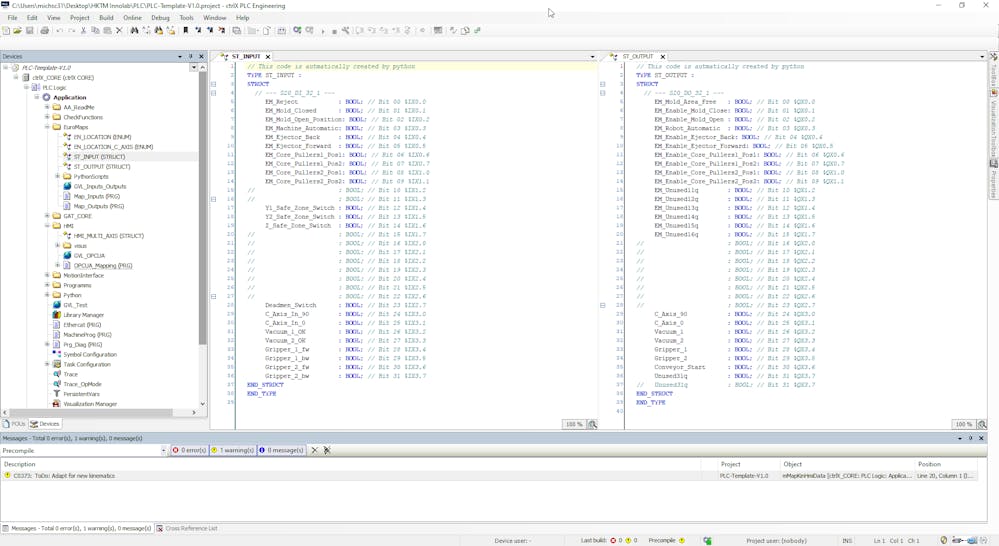

Is our ctrlX cartesian robo solution Meet the standards of Euromap 67 or Euromap 67 compliant?
In the template for Cartesian handling systems we provide the variables are sent via OPC UA in Euromap standard. Feel free to check it out on your own.
Euromap HMI
Euromap PLC
Euromap Data Layer
Euromap OPC UA
