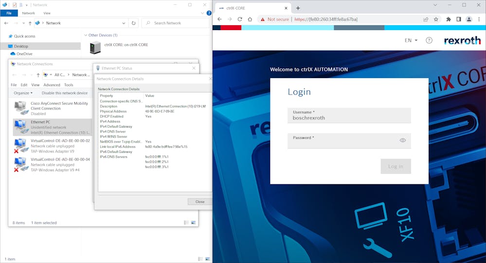

But via IPv6 the control is always reachable independent how IPv4 is set up. The UPNP service is used for that:
Windows network settings IPv6 connection ctrlX CORE web UI
