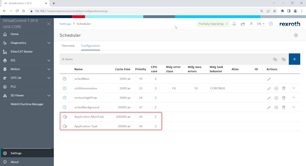

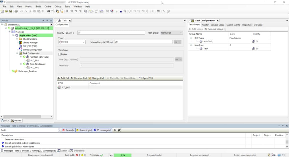

PLC Tasks in standard are running on core 2 but with an multi core license available you can shift it to any core you like:
ctrlX PLC Engineering - multi core task settings
ctrlX CORE WebUI - scheduler settings with PLC multi core
But I agree to Sgilk you should check out what creates the load to your data layer and also check which load is created by your PLC tasks.
