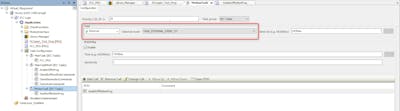

The scheduler of the trlX CORE provides a predifined PLC trigger signal which will be synchronised to the ethercat.
This signal can be used as an external task trigger at the PLC engineering
