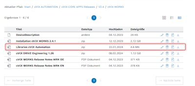

Best reply by Jochen_Mueller
Hello
it is a known bug and solved with new MotionInterface libs available at the colaboration room. After installing the libs at the library repo you have to adjust the placeholder versions manual.
With this the motion interface can be initialized also you have axis name longer than 10 characters.
LINK
