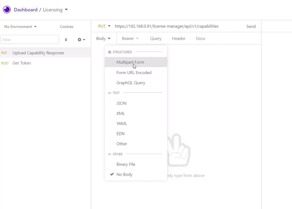

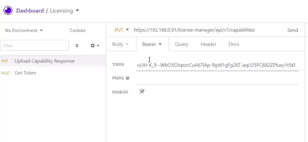

  4. Now create a PUT request. Choose bearer-token as authentication method and paste the copied access_token there.

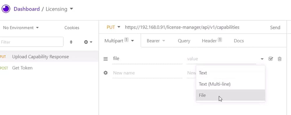

  5. Then change the body type of the request to “multipart form” and create a field called “file” with the license-file as value.

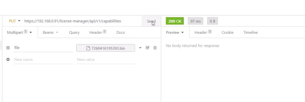

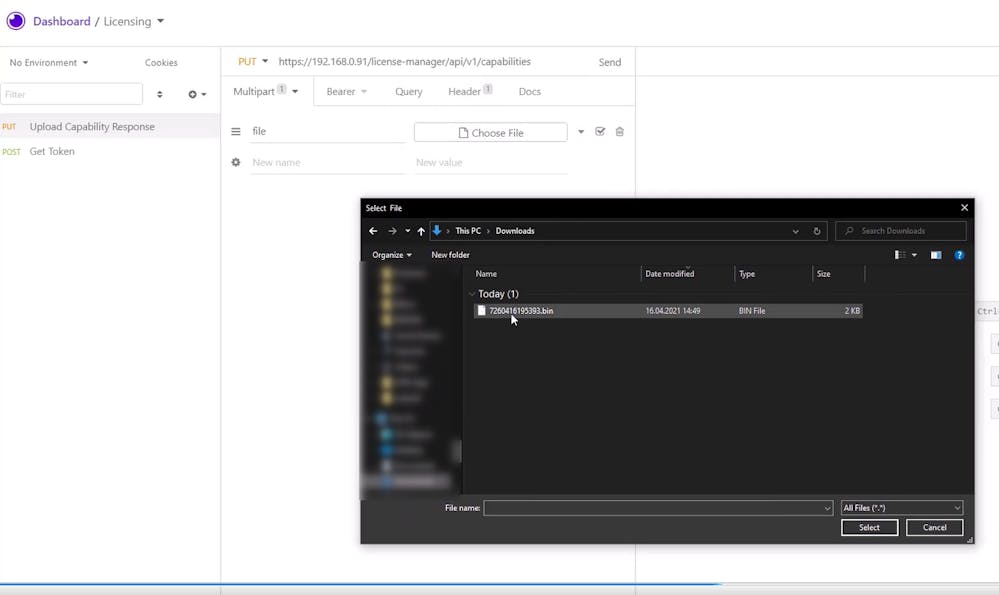

  6. Upload the license file (capability response) you downloaded from the Bosch Rexroth Licensing Center. See here, how to get a license for your app.
  7. After sending the request, check if the response says “200 OK”.

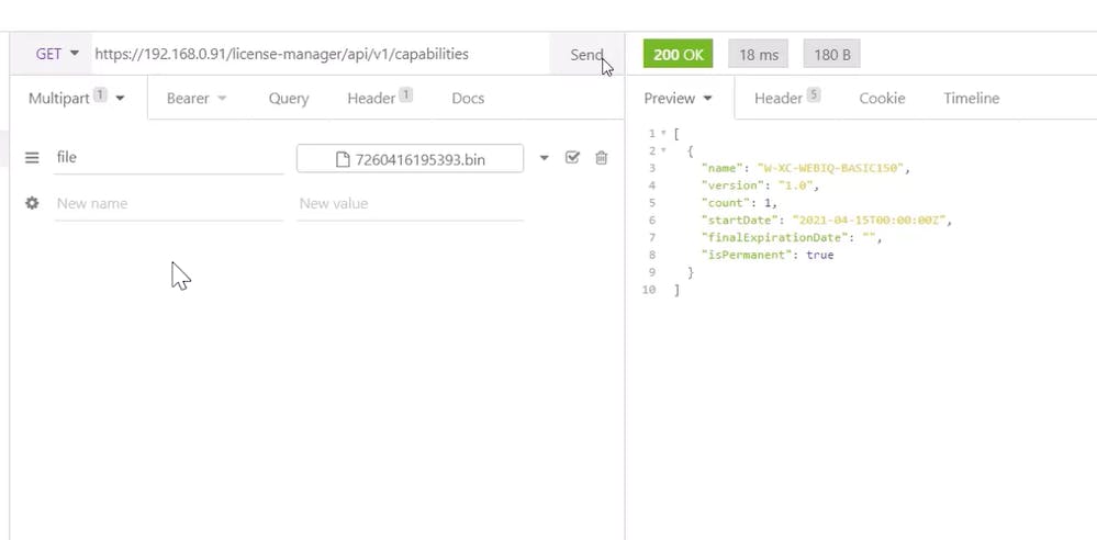

  8. Now you can change the request to “GET” and send it again to see what licenses are available.
