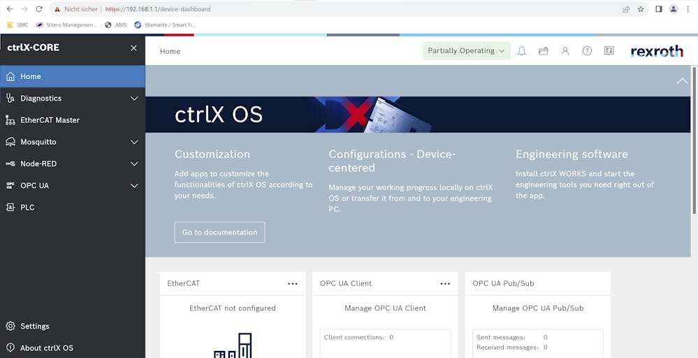

  • Open ctrlX CORE user interface in your browser.
crtlX OS user interface

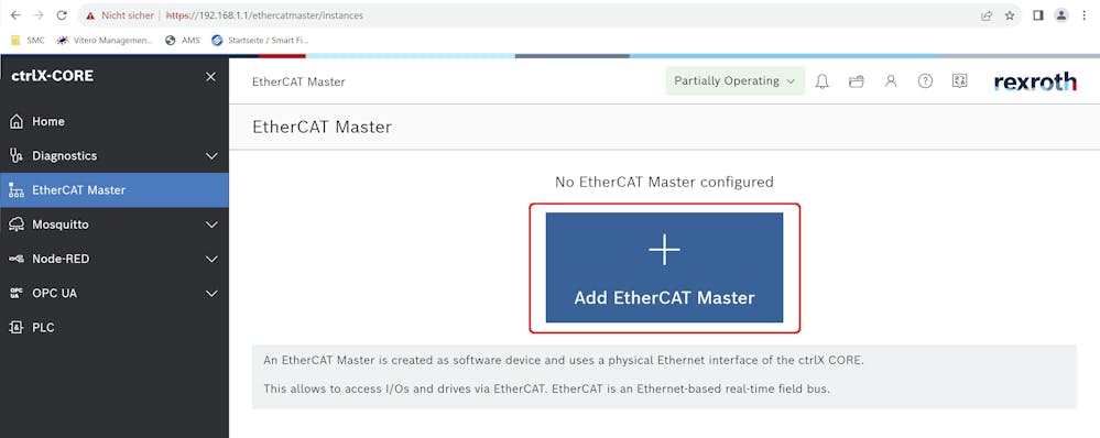

  • Add EtherCAT master by clicking “+” in EtherCAT configuration.
crtlX EtherCat configuration

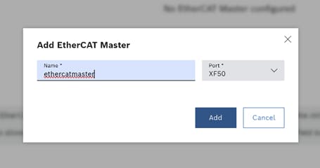

  • Add EtherCAT Master and give it a name.
crtlX EtherCat Master

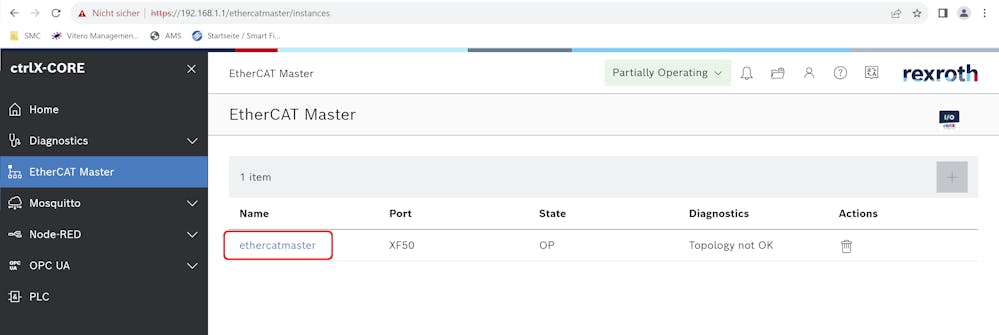

  • Open ctrlX I/O Engineering by clicking on the Name of the Master system.
ctrlX EtherCat Master

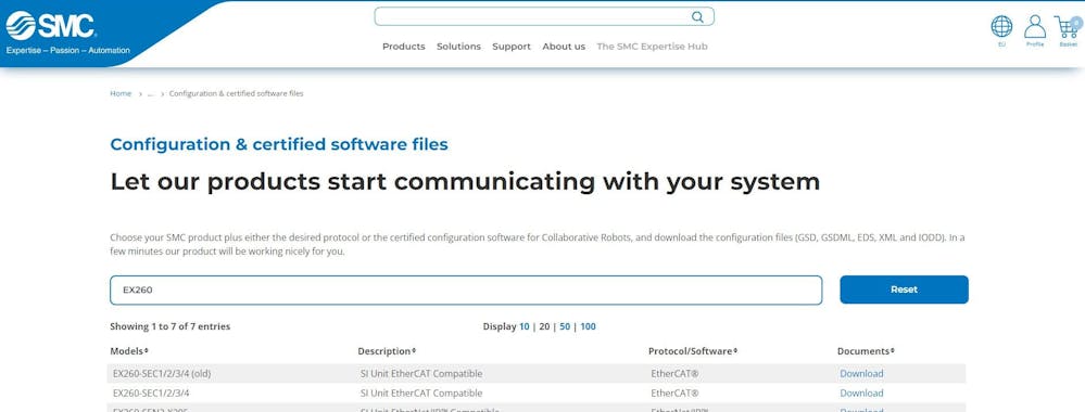

Step 2: Install the EX260 device description
SMC Download page

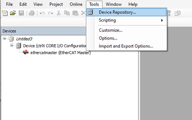

  • Install the device description in the “Device Repository” chapter in the software.
ctrlX device repository

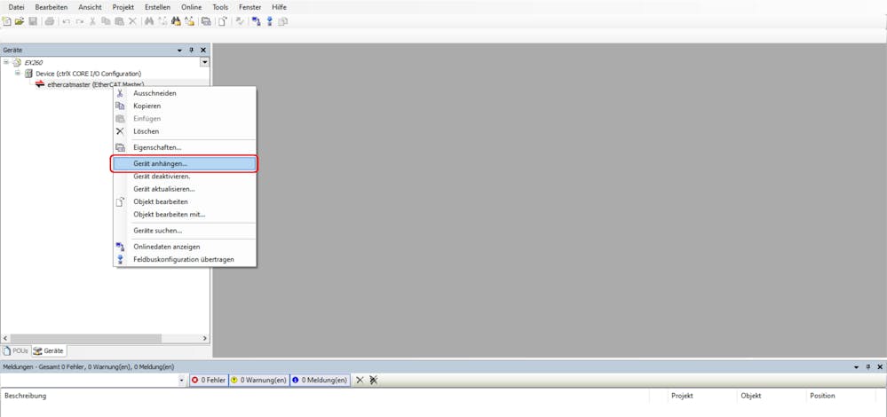

  • Add device to EtherCAT Master by right-click in the device tree on ethercatmaster.
ctrlX add device

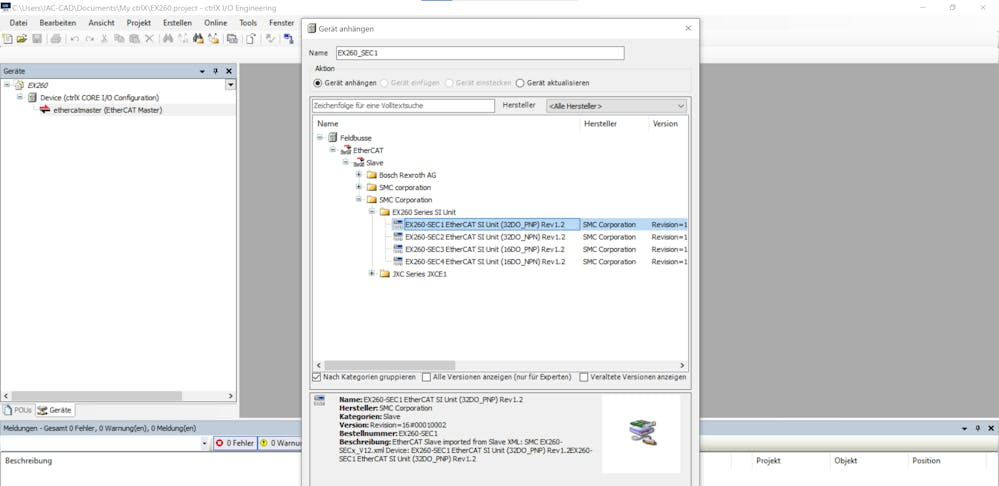

  • Choose the relevant device description for your device from device catalog and add it.
ctrlX SMC device catalogue

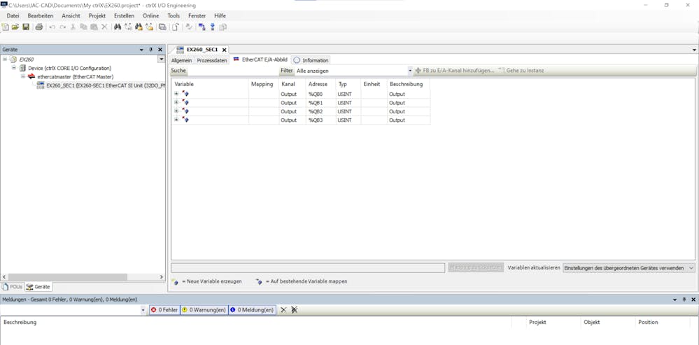

  • The EX260 valve manifold controller is now installed and available.
ctrlX SMC device ready
