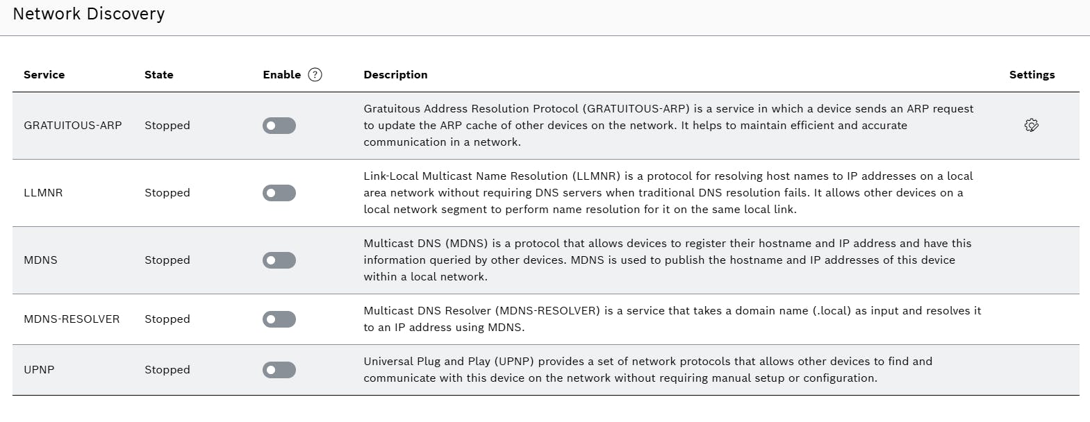

Note2: please deactivate the Discovery Services to avoid unwanted app behavior, see picture at the end of the Article.

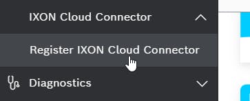

Once installed and licensed the app will appear on the left part of our sidebar, we have to click on "Register IXON Cloud Connector":
IXON Sidebar

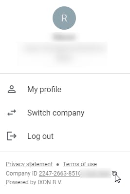

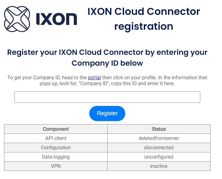

We have to insert our company ID that we can find online on our account on the top-right of the page, this procedure may thake some seconds and you may have to insert the ID some times, better to use an updated browser:
Insert Company ID
My CompanyID

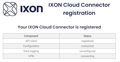

After we click on "register" and the connection has been established the device will be available in our "Fleet Manager" ready to be activated.
Device Activated
IXON gives the possibility to activate the device from a template, in this case it is the first time for me and I have no templates to use.
Fleet Manager - Add new devices
 It is now possible to use IXON with our ctrlX CORE.

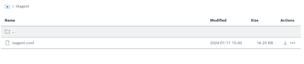

Delete the configuration
It is possible to delete the configuration inside the "AppData", in case we have wrongly registered the device.
Delete IXON configuration
Temporary Workaround
It is possible that the "Discovery" services in ctrlX OS are interfering with the IXON app. In case you are facing issues, please disable the discovery mechanism (Settings->Network Discovery).
