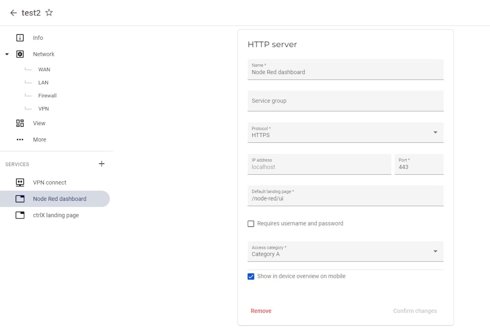

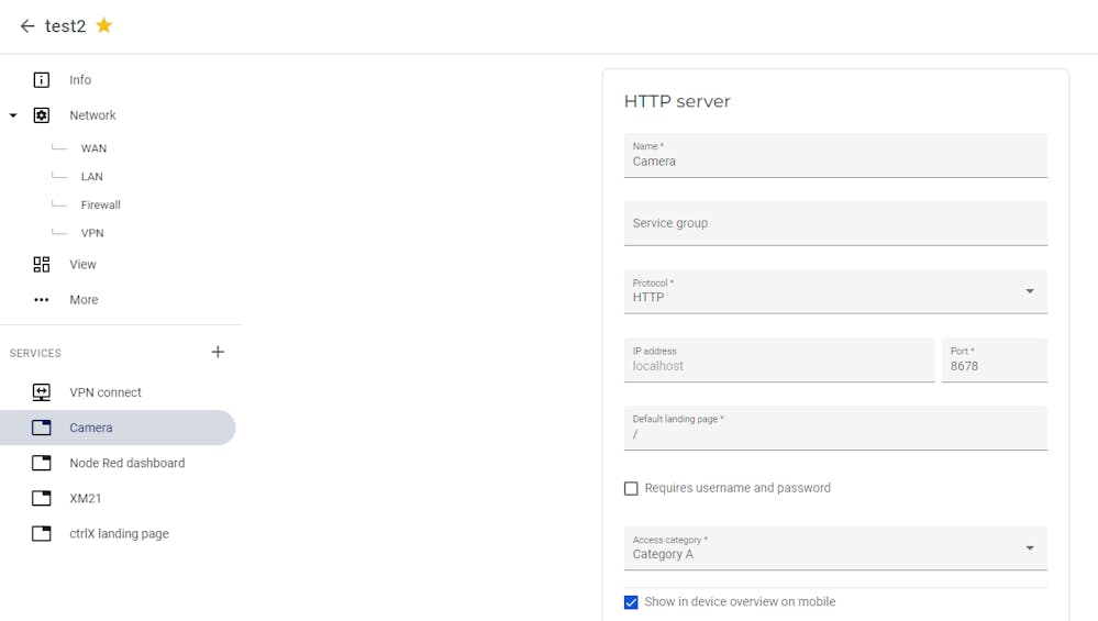

Now we can set the default pages which are pointing out to ctrlX Automation front page and to a Node-RED dashboard. The pages can point to whatever device webpage.

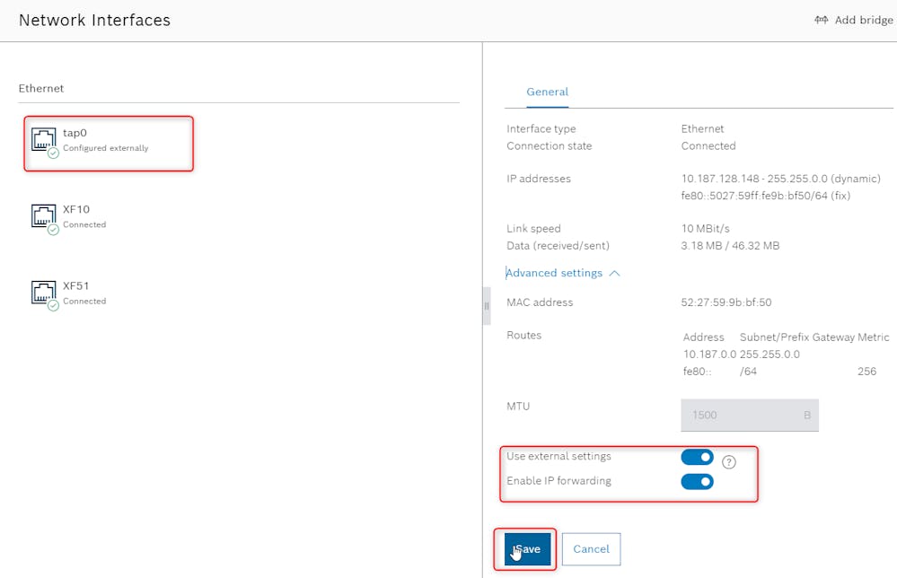

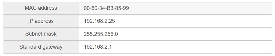

To achieve this result we first have to enable the "Enable IP forwarding" option for "tap0" and any other interface we need to share. Additionally any device that has to be used remotely has to set the ctrlX CORE IP address in his network as gateway, e.g. the XM21 has 192.168.1.25 as IP address. I need to set 192.168.2.1 as gateway because it is the address of ctrlX inside this network. This setting can be avoided, if we use the Firewall app.
VPN setup
Gateway settings for an XM21: this avoids the necessity to have the firewall app installed. 192.168.2.1 is the ctrlX CORE address.

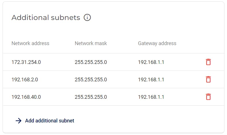

To access some devices which are behind the ctrlX itself, we also need to add the devices IP address on the list of the network. For instance, if we want to communicate with the drives which are connected via Sercos to our XM21 we have to add their address on the network list. The same if we need to communicate with EoE devices connected to ctrlX itself. So in this case we have:
  • 192.168.1.0: standard router network. Not listed here.
  • 192.168.2.0: Secondary network connected with the machine, XM21 is connected here.
  • 192.168.40.0: EoE network connected to ctrlX.
  • 172.31.254.0: Sercos network. Not connected to ctrlX but to our XM21.
IXON subnets setup

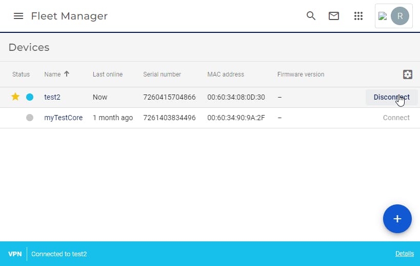

Now we can connect to the device using the "connect" button. Once we are connected we can contact the devices using their original IP addresses. Nothing more easy.

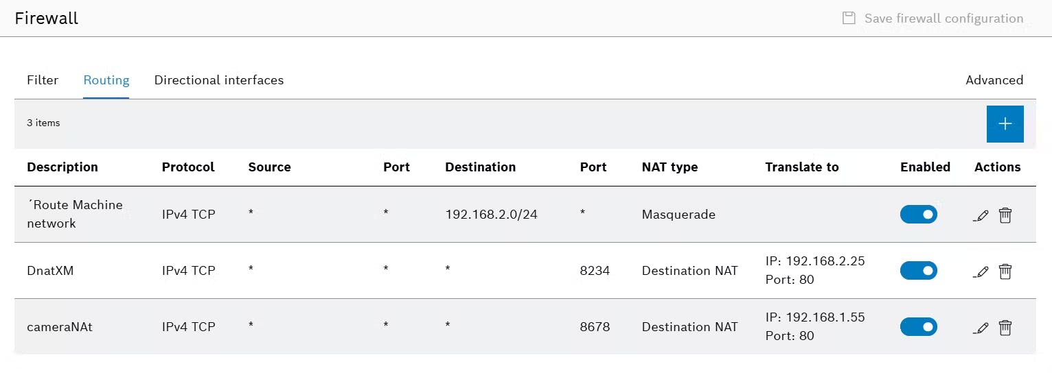

Since version 3.6 the firewall simple (R911430062 - SWL-XC*-FRW-FIREWALL*****-BANN) is needed to implement the routing. Here are the settings needed, the full guide is written here: Firewall basic guide.

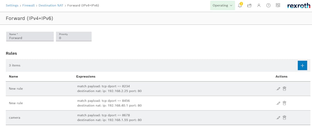

I report here the settings done in my firewall. The XM21 (192.168.2.25) 80 port is forwarded to ctrlX CORE 8234 port. I have additionally an IPCAM (192.168.1.55) which is forwarded to port 8567.
Firewall advanced 1
Firewall advanced 2

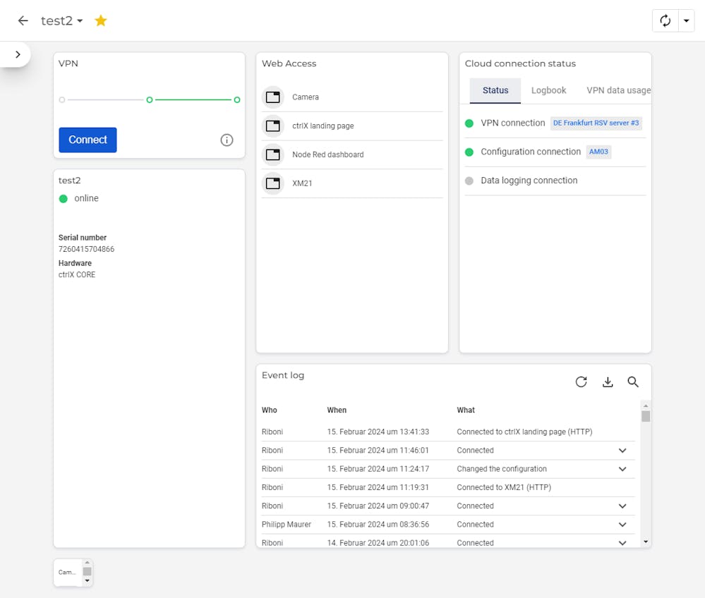

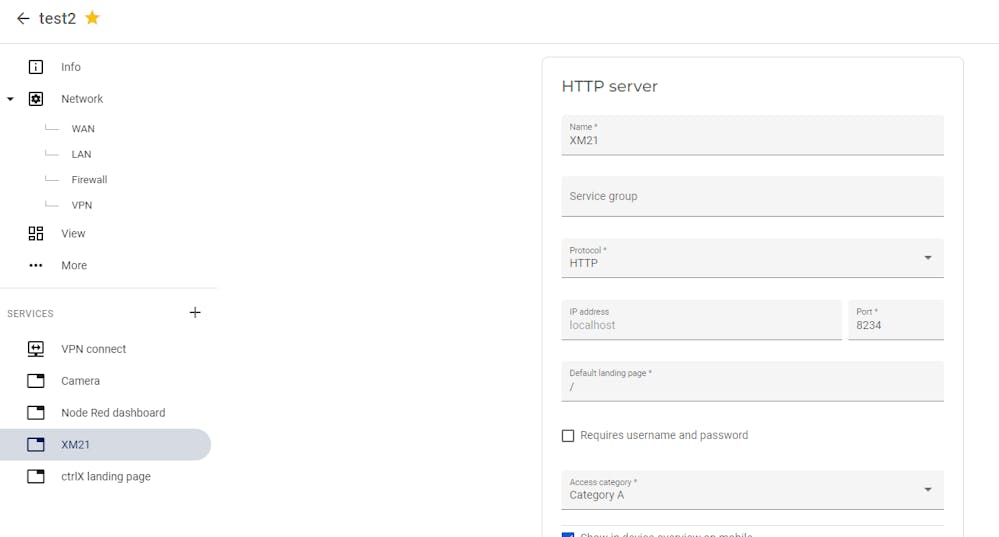

Now if we want to show directly the XM21 web portal and the IPcam webpage we just have to add them as a service in the IXON setup. From just this page without VPN we can connect to the webserver of any of these devices.
Service advanced
Service advanced
The final result is the follwing:
IXON final result

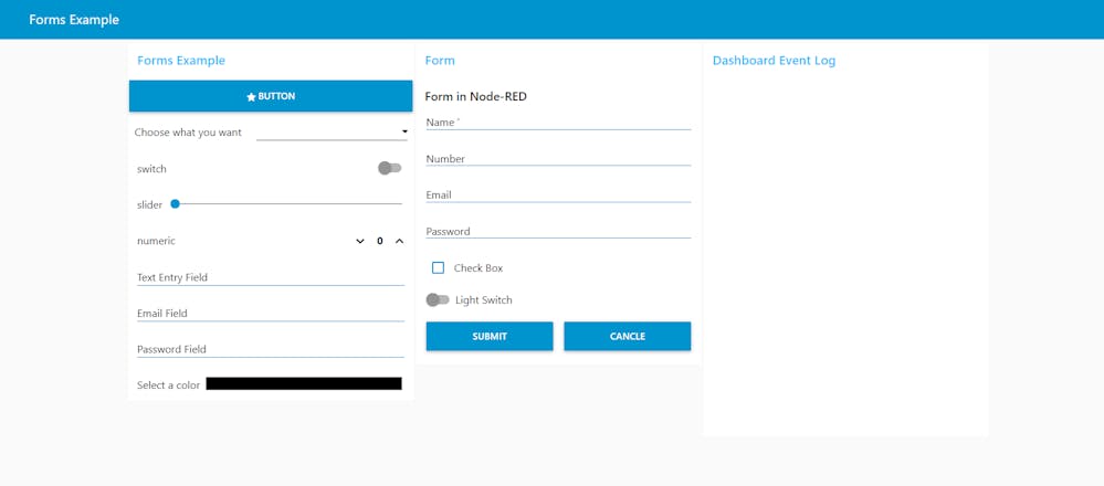

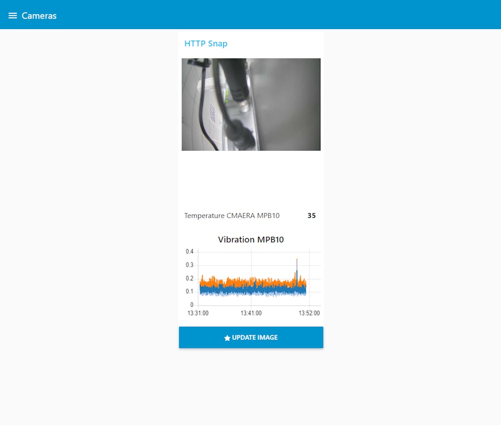

NODE-RED remote
Node-red Management remote
Camera Remote management

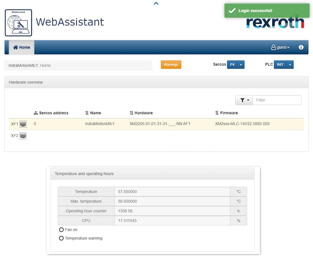

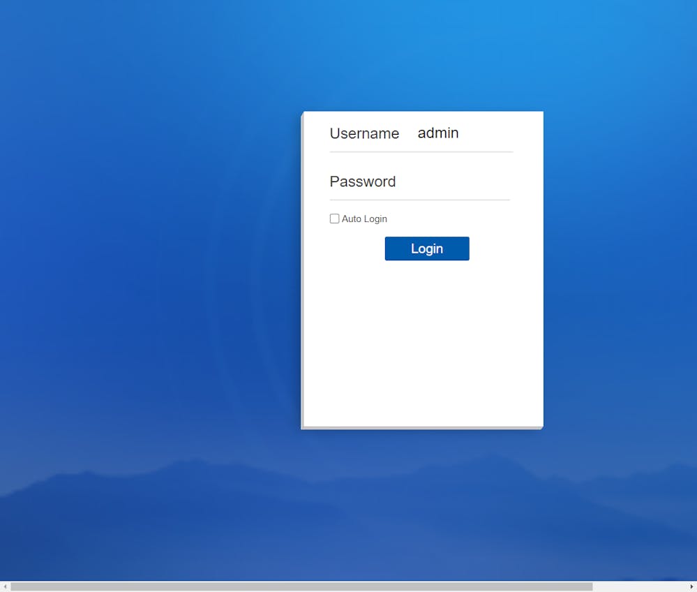

XM21 WebAssistant

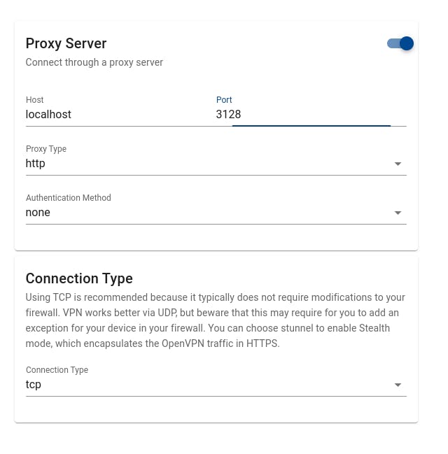

Many corporates are using Proxies inside the company network. IXON can work (PC side) also in this situation. The procedure is similar to: connect ctrlX CORE VIRTUAL to internet using PX proxy. So it is suggested to test this guide first. Once anything is set and PX is working we have to go to: "Fleet management" then "Tools" then selet the "details" field of the VPN client and enter the options below (if the PX setup is standard). Happy remote connection. Remember to start PX anytime you need this feature.
IXON settings for PX proxy
