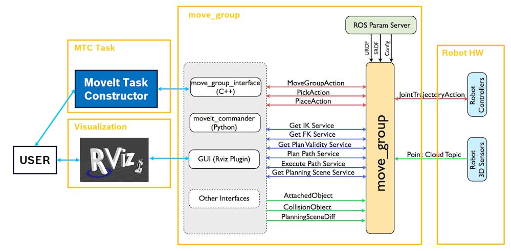

Let's first understand how MoveIt2! works.
The MoveIt2! package main functionalities are included in the "move_group" ROS2 node. This node receives inputs from the user and is able to plan low-level robotic actions thanks to its knowledge of the robot configuration (loaded in the ROS Param Server). Moreover, it communicates with the robot hardware, i.e. sensors and controllers, in order to get environment information or deploy actions respectively.
The user interface to the "move_group" can be done via C++, Python or directly from Rviz. However, this way of interacting with the planner is really low-level. For this reason, MoveIt has developed "MoveIt Task Constructor" (MTC). MTC is a higher-level layer of abstraction that allows the user to easily plan complex tasks, in which several several sub-tasks are involved.
With this ideas in mind, the system architecture would be described as presented in the following picture.
Concept diagram

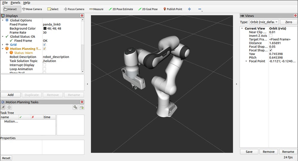

You should see the robot in this specific pose.
Robot in ready pose
If it's not exactly like this, it means the initALL routine failed in the ctrlX CORE. In this case, shut it down with ctrl^C and call the command again. 

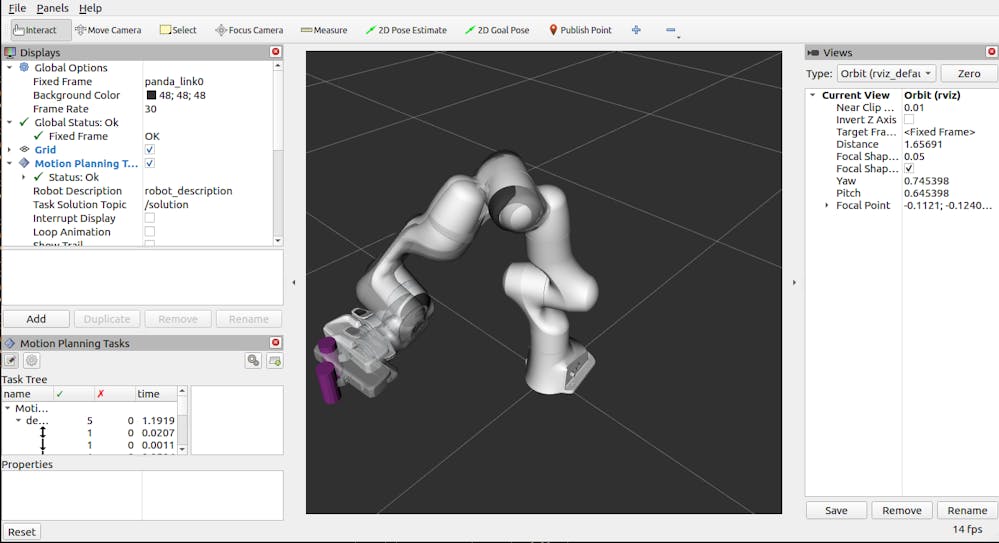

If everything is correct, you should see the robot moving.
Robot executing task
