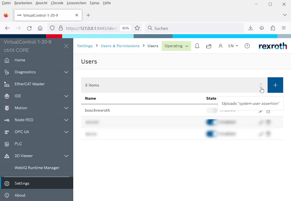

2 - Upload user assertion
Afterwards you will get an assertion file that can be uploaded to the ctrlX CORE via the user management page ("Settings/Users & Permissions/Users") and adds the system/root user. This is for development purposes only! Your ctrlX CORE will be marked as unsafe device further on and must not be used in production mode. You will have to sign a corresponding agreement that you are aware of the risks and consequence. Beware that your time and date needs to be set corretly in the ctrlX OS.
ctrlX CORE web UI - upload user assertion

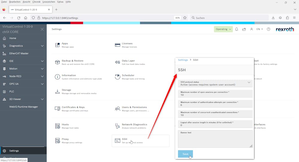

3 - Activate SSH
As soon as a system user is available in the ctrlX CORE the SSH connection can be activated via "Settings/SSH":
ctrlX CORE web UI - activate SSH
