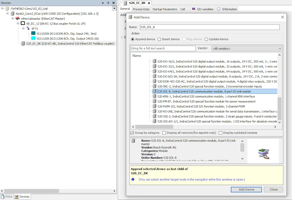

In ctrlX IO Engineering, scan for devices and apply them to the IO project. Then under the S20 EtherCAT bus coupler, manually add the S20-IOL-8 module. Make sure all devices on the EtherCAT bus coupler are in the correct order.
Then download the configuration to the ctrlX CORE. If the 'D' status indicator LED on the S20-IOL-8 module is not active at this point, cycle the EtherCAT master.

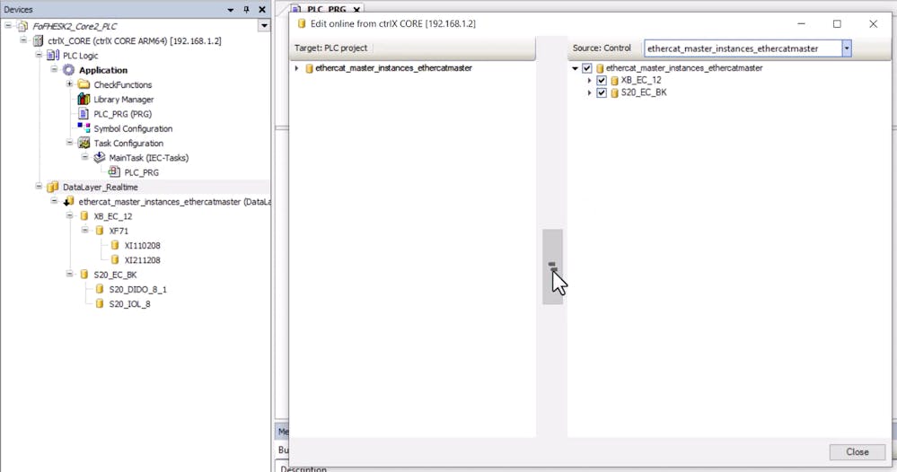

In the PLC engineering software, add the EtherCAT master info to the Data Layer.
Enable the S20-IOL-8 in the Data Layer.

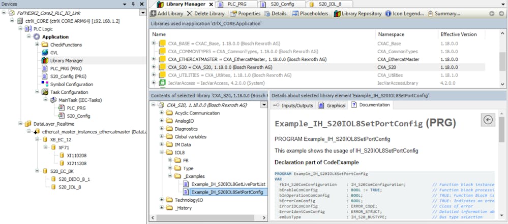

Add the CXA_S20 library, then add the example code for IH_S20IOL8SetPortConfig and IH_S20IOL8GetLivePortList, in the IOL8 folder, to a POU in your program. You only need one instance of IH_S20ComConfiguration.

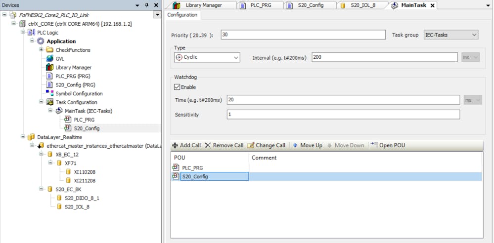

Remember to add the configuration POU to the Main_task.
