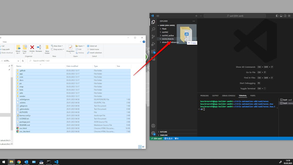

  • Introduce the downloaded files in the new created folder.
For that, first drag all the noVNC files into the main folder as shown below:
novnc files copy to the project folder

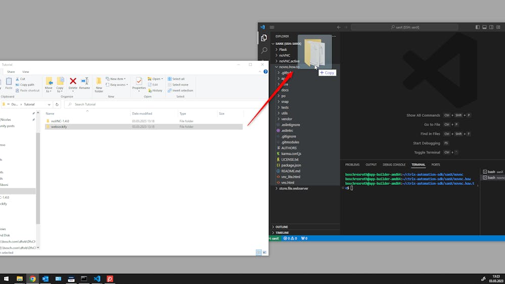

Secondly, change the websockify folder name to "websockify", to simplify the access to that folder later on, and copy the folder in the main project folder.
websockify folder copy to the project folder

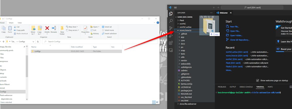

  • Drag the "configs" folder into the general project folder
configs folder copy to the project folder

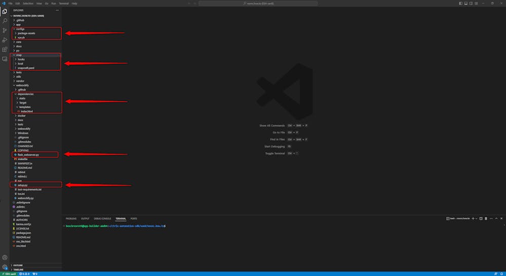

  • Check that all the added folders are in the project:
Copied files check

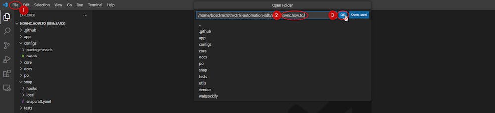

  • First the user must be located in the project folder
  1. Press "File" --> "Open folder"
  2. Select the folders until selecting the main project folder
  3. Press "Ok" and the folder will be opened

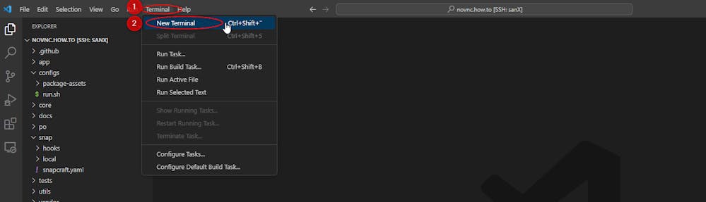

Terminal window access
  • Press "Terminal" and open a "New terminal"

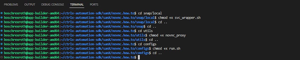

  • Make files executable
To be able to succesfully build the snap, it is required to make some bash files executable because otherwise the following messages will appear for the different files:
Error message when the chmod +x command has not been executed
  • In the terminal, with the "cd" command, access the snap/local folder where the svc_wrapper.sh file is located:
cd snap/local
  • Next, use the "chmod +x" command to make the file executable:
chmod +x svc_wrapper.sh
  • Return to the main folder using the command "cd .." twice:
cd ..
cd ..
  • Perform similar steps for the novnc_proxy file:
cd utils
chmod +x novnc_proxy
cd ..
  • Perform similar steps for the run.sh file:
cd configs
chmod +x run.sh
cd ..
Executed commands overview
