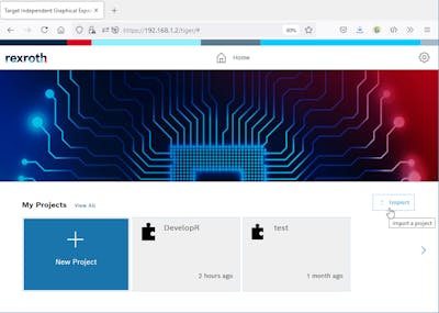

Graphical Coding
  1. Download the archive "
    Data.zip
    7.4KB
    " to your engineering PC.

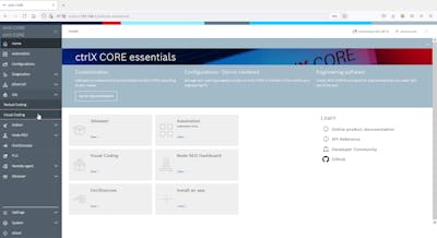

  2. Log into the ctrlX CORE and open the Visual Coding functionality of the IDE App:
  3. Import the project file into the IDE:
  4. The project will open up automatically and you are good to go.

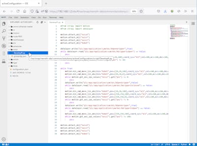

Textual Coding
    Data.zip
    7.4KB
    " and unpack
    the file "DevelopR.py" to your engineering PC.
  2. Log into the ctrlX CORE and open the Textual Coding functionality of the IDE App:
  3. Upload the python file via drag and drop to a folder in the explorer view or right click and choose upload files:
  4. Click on the uploaded file and you are good to go.
