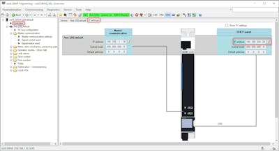

You do not need to change IP address settings of mentioned Ethernet adapter because panel is coming with DHCP server. But if needed you can define a fix IP address in network 192.168.222.y (y needs to be different from last number of drive engineering IP)

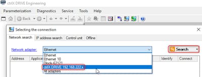

Open ctrlX DRIVE Engineering select ctrlX DRIVE panel Ethernet adapter (here ctrlX DRIVE 192.168.222.x) and browse for drive
The search will find your connected drive according to your IP settings on ctrlX DRIVE side:
