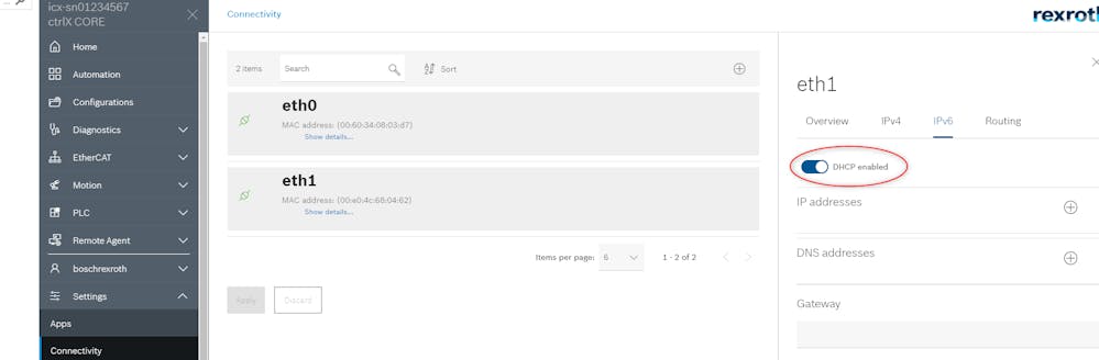

Make sure DHCP for both IPv4 and IPv6 are enabled in your Connectivity settings of your ctrlX CORE before connecting to the Internet.

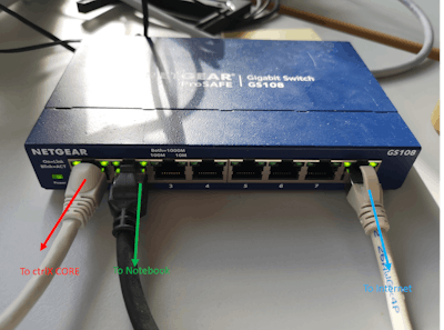

Option 1: Using a Switch
Connect both your Notebook and the ctrlX CORE to a standard Switch. Then connect the Switch to the Internet.
How To: Connect ctrlX CORE to internet using a portable router

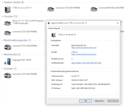

Once plugged in, navigate to File Explorer → Network and find the Network Adapter of your ctrlX CORE. Right click and select properties.
Under IP-Address or Device-Webpage you can find the address to connect to your Device through the Web Browser. Click on it and log into your ctrlX CORE. Navigate to Settings → Connectivity and select your Network connection. If you do not want to use the current address you can check here all the assigned IPs to your device.

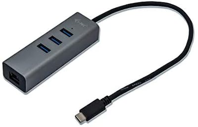

Option 2: Use a USB-C to Ethernet Adapter
Optain the following USB-C to Ethernet Adapter compatible with the ctrlX CORE:
Compatible devices with ctrlX CORE can be found in the internal Forum.
USB Ethernet Adapter
Typei-tec USB-C Metal 3-Port HUB Gigabit Ethernet Adapter
Supplier

Navigate to the device webpage and check the Connectivity Tab. There should now be a second connection available. Select it and again ensure both IPv4 and IPv6 have DHCP enabled.
