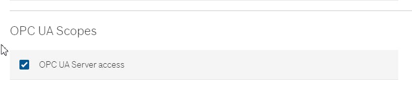

Check permission UA Server access  of your current user. The default user boschrexroth should have admin rights.

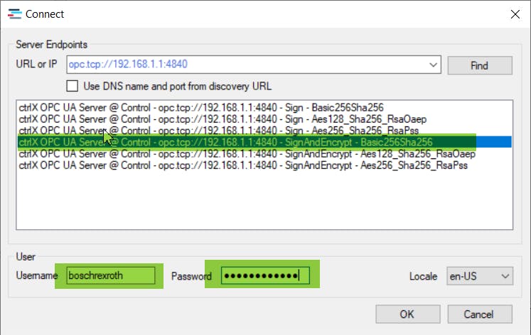

Enter your ctrlX IP and credentials like shown below and press <Find>.
Choose one of your preferred endpoint by policy (recommended: SignAndEncrypt Basic256Sha256. Not supported yet: Aes256_Sha256_RsaPss)
Enter your username/password credentials and press <OK>.

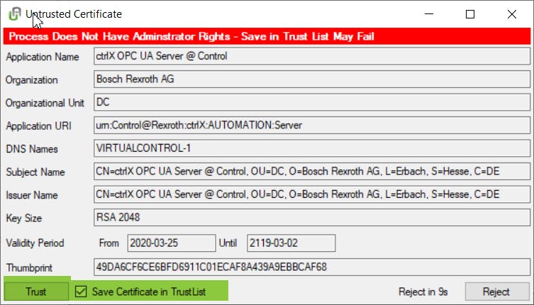

Now you have to trust the server's certificate manually.
Press <Trust> and check <Save Certificate in TrustList>
You should get an <BadSecurityChecksFailed>  error from server, because the server is not trusting your certificate by default.

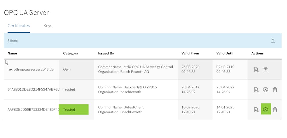

Login into your ctrlX website, navigate to Settings → Certificates & Keys and press the <Check> Button on the right pane to trust your client certificate.

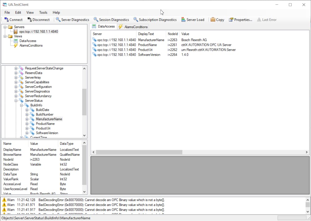

Reconnect: Done, your connection should be established!
Have fun using the UA.TestClient !
