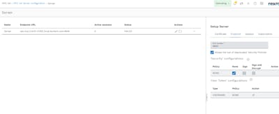

it looks like, that the server settings are not right and so the server fails to start. If I look to the screenshot I miss some entries for the Security configuration and for the User Token configuration.
Did you modified the settings by yourself? If yes, what was your goal?
If you want to allow a unsecure connection, it's enough to enable the "NONE" secure endpoint. To communicate with older client's it's sometimes needed to enable "Allows the use of deprecated "Security Poliecs"".
But a authentication is always needed. And it's not possible to communicate with the OPC UA server of the ctrlX without authentication (user/password)
Please reset the server settings to default as described inside this post. LINK
After this procedure, the server should run again.
