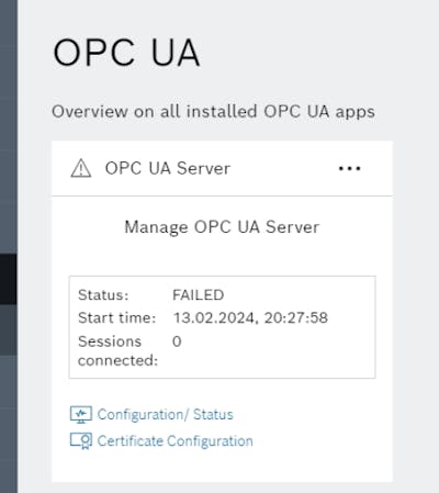

Hi, I have OPC UA Server 1.20.3 which has notified status Failed all the time. I am trying to reinstall OPC UA App but it doesn't fix the problem. I am even trying to install newer version of OPC UA Server. How to solve this problem without Factory RESET? Thank you in advance.

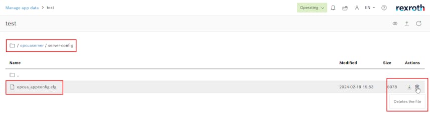

you can reset the OPC UA server by deleting the configuration file "opcua_appconfig.cfg".

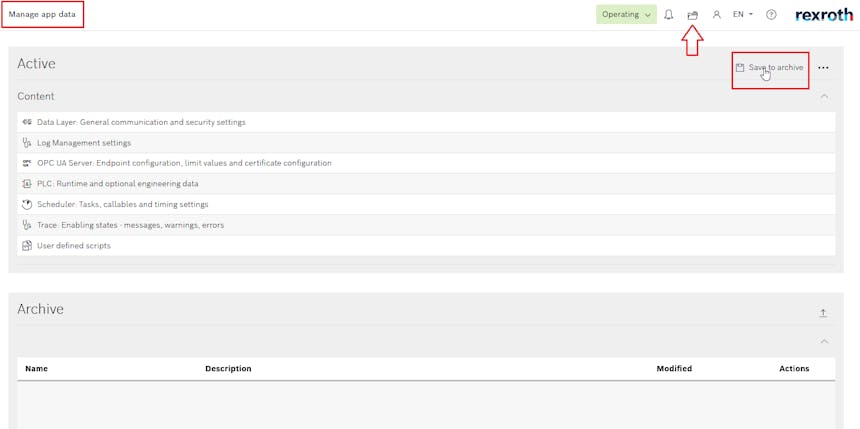

Therefore please navigate to "Managed app data" and press "Save to archive"

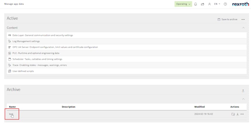

Open the saved archive
and navigate to "/opcuaserver/server-config" and delete the "opcua_appconfig.cfg".

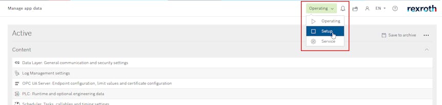

Navigate back to "Managed app data" and switch the operation mode to "Setup" (this is only needed if a real time app, like the PLC is running).
Load the modified configuration
