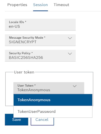

Within the OPC UA Client app I can only choose between "Anonymous" and "Username/Password". There is no direct option to choose a certifcate. Since there are possible ways to upload certificates within CtrlX Core I hope that there is also a possibility?

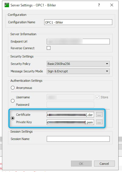

The connection in trial is established using the UA Expert tool where I am able to assign and choose the certificate way.
Working: UA-Expert (certifcate):
CtrlX core:

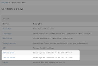

Certificates within CtrlX Core:

the OPC UA client, inside the ctrlX CORE, only supports authentication with user/password (or anonymous).
The authentication with certificate and private key, you are searching for, is actual not implemented.
