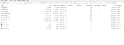

Earlier we had MLPI with XM and CML series of controller
Is the same option available with ctrlX ?
