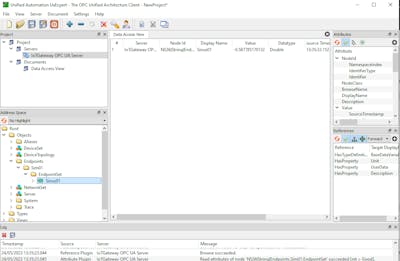

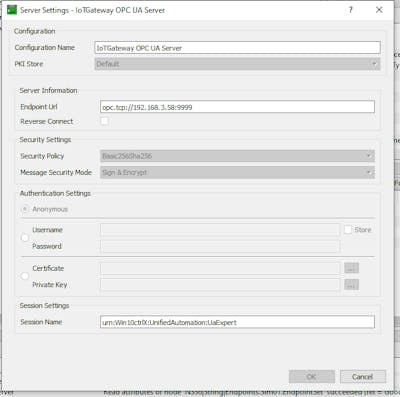

I tested it OPC UA connection to the IoT Gateway with UA expert and it works fine :Â
With following settings:Â

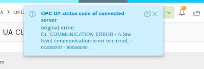

Now, when I try to connect my ctrlX OPC UA client it does not work, I have always an error : DL_COMMUNICATION_ERROR:Â

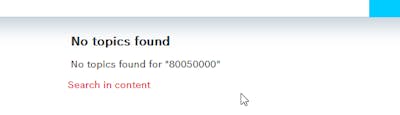

I searched on ctrlX user manual and alos with the question mark : (?) on the error but the description is empty :

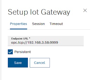

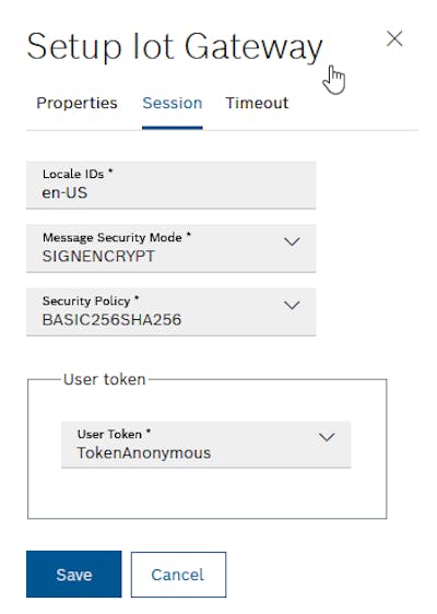

Here are my client OPC UA settings :Â
