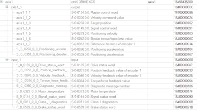

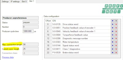

Trying to add a ctrlX drive with enough data to a Profinet master does not work. In picture one everything is ok and the profinet master finds the correct modules in the drive and profinet communication can be established.

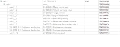

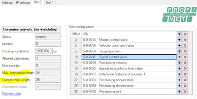

In picture two, one 4 byte parameter is added to the drive mdt, and the master does not find the input module anymore. The profinet communication can not be established. Am I missing something or is this a feature of the system?
