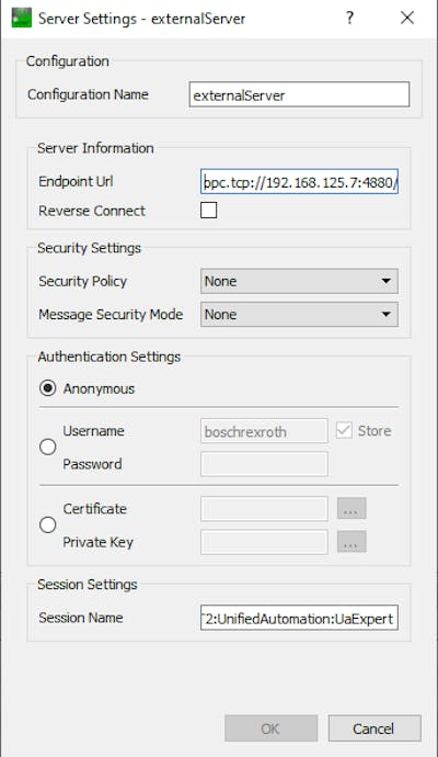

I have an OPC UA Server with the following server settings:
I can connect to the Server with UAExpert without any problems.

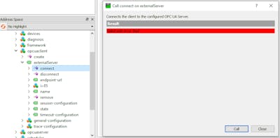

I can add the Server in the opcuaclient-node with the "create" method. But when I try to use the "connect" method I get: "The method has no arguments" "Call failed with status 'Bad'"

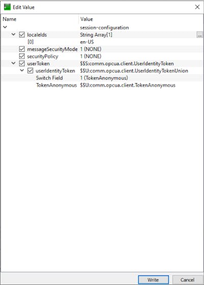

My session-configuration is:

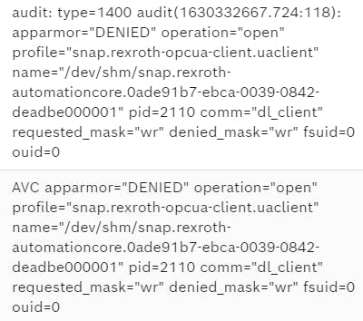

In the logbook on my ctrlX-Core-virtual I get the following:

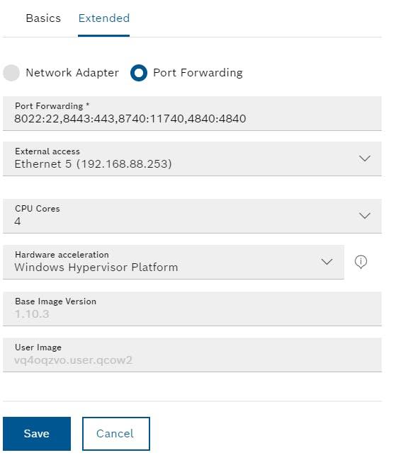

Hi mauricej,
you have to use "Port Forwarding" and select in "External access" the right network adapter.
If you have still problems you should first deactivate your windows firewall and see if it works, if so you need to adjust your firewall.
