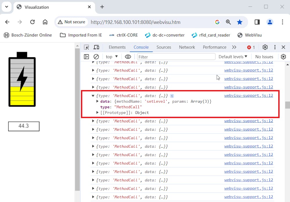

Unrelated question:  Is it possible to suppress the console entries that are logged automatically whenever the prototype functions are called?

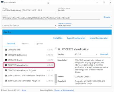

UPDATE: The issue with Html5ControlEditor.exe in CODESYS 3.5 SP19 appears to be acknowledged as a bug in the release notes for Visualization package 4.4.0.0:
ctrlX PLC Engineering 1.20.5, which as noted above is based on CODESYS SP19, ships with Visualization 4.3.0.0:
I was not able to find the latest package (Visualization 4.4.0.0) as a standalone item on the CODESYS store.   @CODESYS: Is Visualization 4.4.0.0 separately available and is it OK to upgrade this package?
