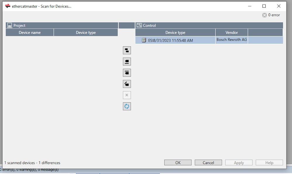

We want to connect a Panasonic MADLT15BF to the Ethercat network,

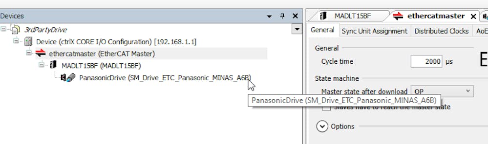

When we add it in the ctrlX IO Software it seems that a Softmotion Axis is added automatically:
The problem is that then in the ctrlX PLC we do not know where to place our Panasonic Softmotion axis because under the datalayer instance of the Panasonic we can just insert a Softmotion Rexroth Axis or a Softmotion Standard Axis

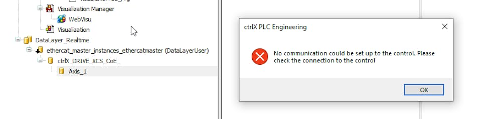

With a ctrlX Drive I also experienced this error, when I added the standard .xml version I could not add the Sofmotion CoE Axis below,
What I did to solve this it was to go to the Drive Engineering > Master communication > RPDO 0 and generate my own .xml
After this I added the .xml to the ctrlX IO software so when I scanned the Ethercat I read my .xml of the device
I transfered this configuration and then in the PLC Engineering I could add the Softmotion CoE axis!
