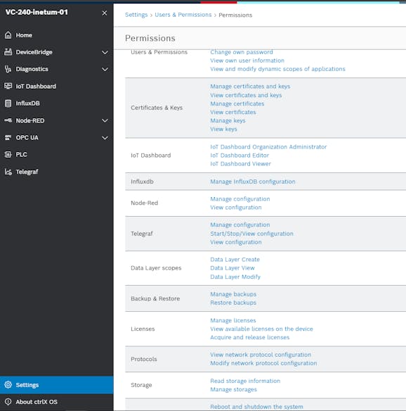

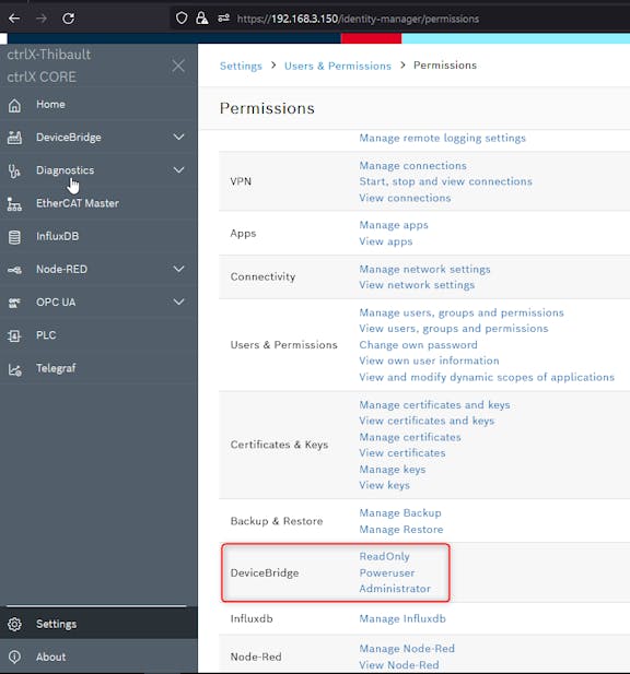

I have installed the last Bosch Device Bridge version 3.2.9 in a ctrlX version 2.4 but there is User & Permission management problem in comparaison of running it in a ctrlX version 1.20
In ctrlX version 2.4 there are no DeviceBridge Permissions :ย
While in version 1.20 there are :ย
This difference brings a problem: boschrexroth user is the only one that can make modifications on Bosch Device Bridge application. If I create a new user, I can not give him the right to make Bosch Device Bridge modifications as Administrator for exemple.
Do you have an idea?
