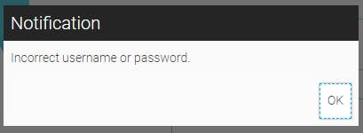

I just updated my WebIQ Server App to 2.16.2 and also installed the matching designer App.
Even though, the credentials were correct, I encountered login problems in the designer App.
Login Problem
After some experimenting, I solved it by adding a new host (not using the localhost 127.0.0.1, but the IPv4 Adress of the ctrlX CORE).
Solution (Create new Host)
Best reply by webiq-sk
Each system has different credentials.
