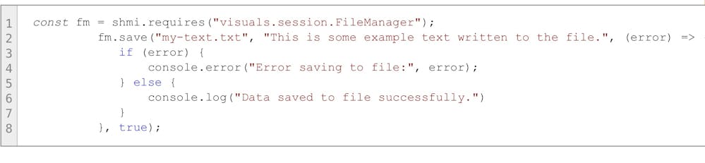

I am looking for a way to read a file that I saved previously through a javascript script in web iq.
Thanks
While a browser can't write to the Web server file system, there is the function FileManager.save() which you found in the WebIQ documentation.Â
Reading a file from the Web server is a basic and common function of the browser, therefore you do not need a special WebIQ function, just use common js script functions. Here is an example with XMLHttpRequest():
