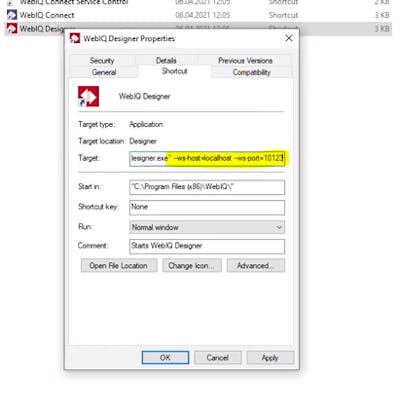

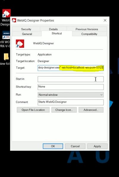

Please will someone be so kind as to explain to me where I can find this? I've been watching several video's now but nowhere do they explain where I can find this so that I can add it to the shortcut on my desktop?

Hello Hendri,
the settings shown in the video (--ws-host=localhost--ws-port=10123 ) have no effect at all as they just set the defaults that are valid anyway - by default WebIQ Designer connects to localhost on port 10123 so you can safely ignore this and do not have to set it.
