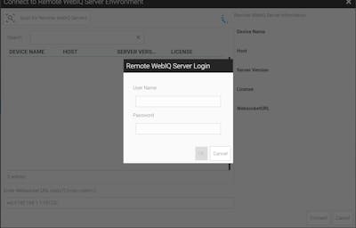

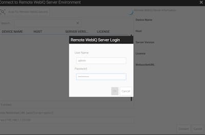

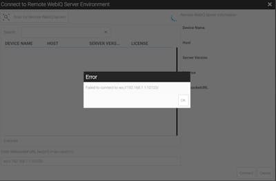

I have installed the WebIQ Designer and now want to publish on my ctrlX core.  I tried to connect to the remote server using the admin / boschrexroth but it fails. I added rules on firewall for port 10123 but still not working.
Proxy is off and no VPN , tried with ws and wss

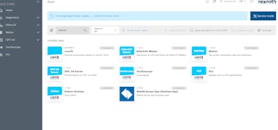

FYI , I was able to connect to the app server after re-installing the WebIQ app on the ctrlX core
