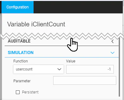

  • Create an item called iClientCount and assign it the function usercount. Although the name is usercount, it means "number of connected clients." See WebIQ Designer documentation for meaning of existing functions.

  • If iClientCount is greater than or equal to 5, the WebIQ project will terminate by displaying an HTML file with error message.
