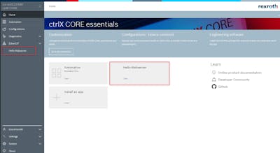

Please have a look into the new SDK (1.4.2). There is a new example in the folder public\samples-go\hello.webserver which shows how to create an app which serves a static webpage and how to integrate a link to this webpage into the landing page and main menu.
I think this is a good starting point for you to place your own web-based screens on the device.
