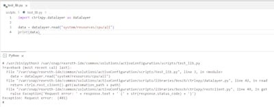

I'm trying to use the Python runtime libraries in the IDE app, but I'm encountering an "Unauthorized request" error.
The documentation doesn't mention the token authorization, and I couldn't find any posts about it.
Do i have to manage it in my code ?

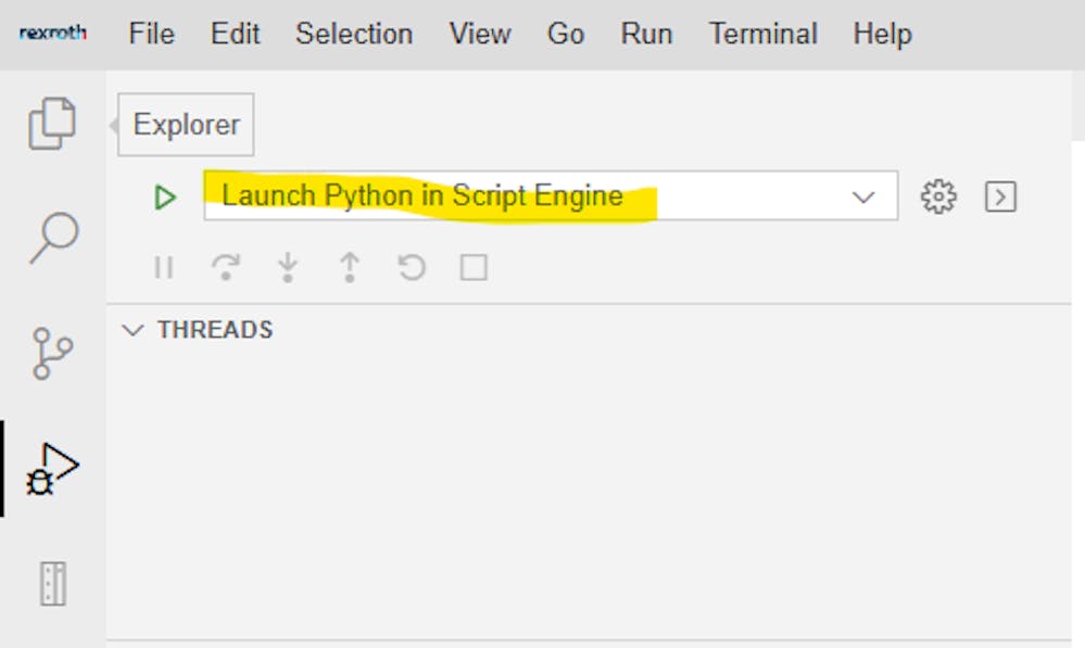

Are you executing the script in the browser or in a script interpreter instance? You'll want to run in an interpreter instance to automatically authenticate on the integrated datalayer library.

You are right, I wasn't executing it in a script interpreter instance. Now it's much better
Thank you Sgilk for all you answers
