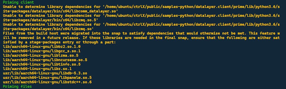

A customer try to compile the python example in the SDK V1.8. using Pi running Ubuntu 18.04 server, but got this warning while building:
screenshot1

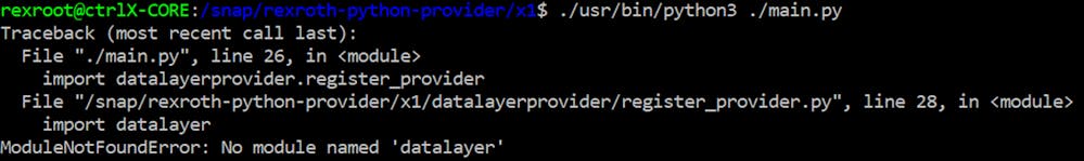

He can install it in the CORE without a problem, but when running he encounter this:
screenshot2
