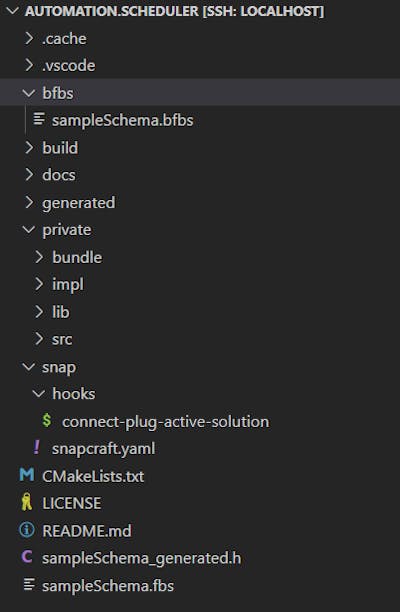

  1. Add the folder "snap/hooks" and the executable "connect-plug-active-solution" to the project.
  2. Make it executable
chmod +x connect-plug-active-solution​​
3  Changes in "snapcraft.yaml"
a) Add part "flatbuffer" to get the .bfbs file into the snap (use organize to make the folder "/bfbs" in the snap)

4  Add command line code in the executable "connect-plug-active-solution" to create a folder and copy .bfbs file to the active configuration
#!/bin/bash
mkdir -p /var/snap/rexroth-solutions/common/solutions/activeConfiguration/bfbs/
cp $SNAP/bfbs/sampleSchema.bfbs /var/snap/rexroth-solutions/common/solutions/activeConfiguration/bfbs/

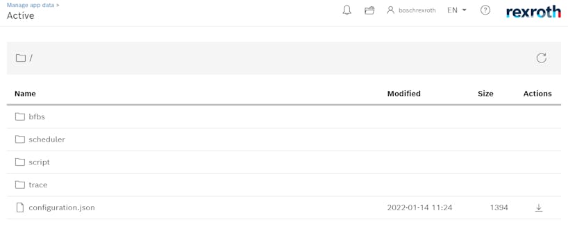

5  You can change the bfbsPath in your C++ programm now to a path to the activeConfiguration:
auto bfbsPath = "/var/snap/rexroth-solutions/common/solutions/activeConfiguration/bfbs/sampleSchema.bfbs";
result = myProvider->registerType("types/sampleSchema/inertialValue", bfbsPath);​
After installation you should see your bfbs file in the folder "bfbs" in the active configuration and your Schema is registered in the Data Layer at "types".
