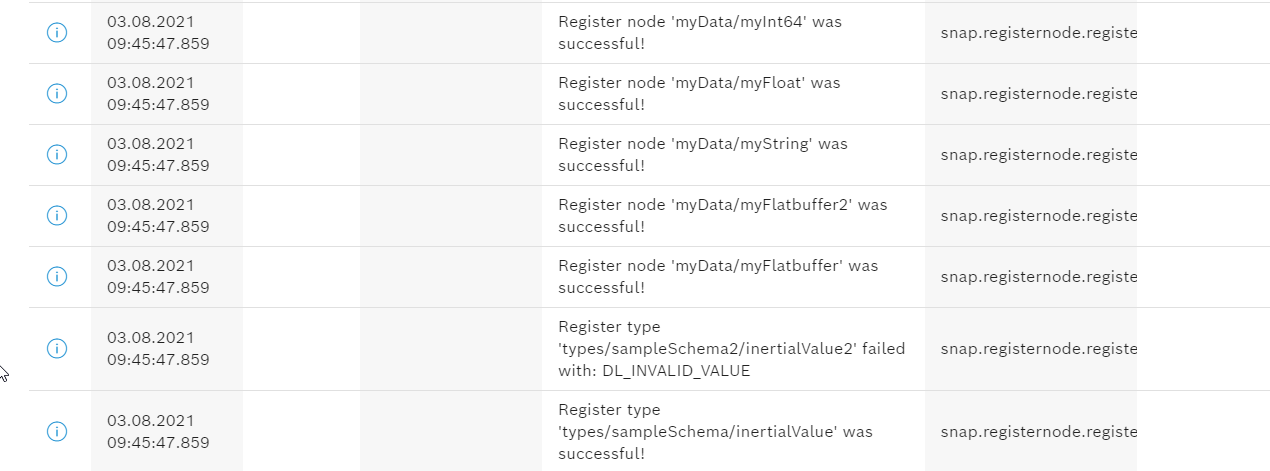

I extended the datalayer.register.node example to include a second flatbuffer (called sampleScheme2.fbs). Now when I start the application, I always see that registerType fails with the message "DL_INVALID_VALUE" for the secondΒ flatbuffer.Β

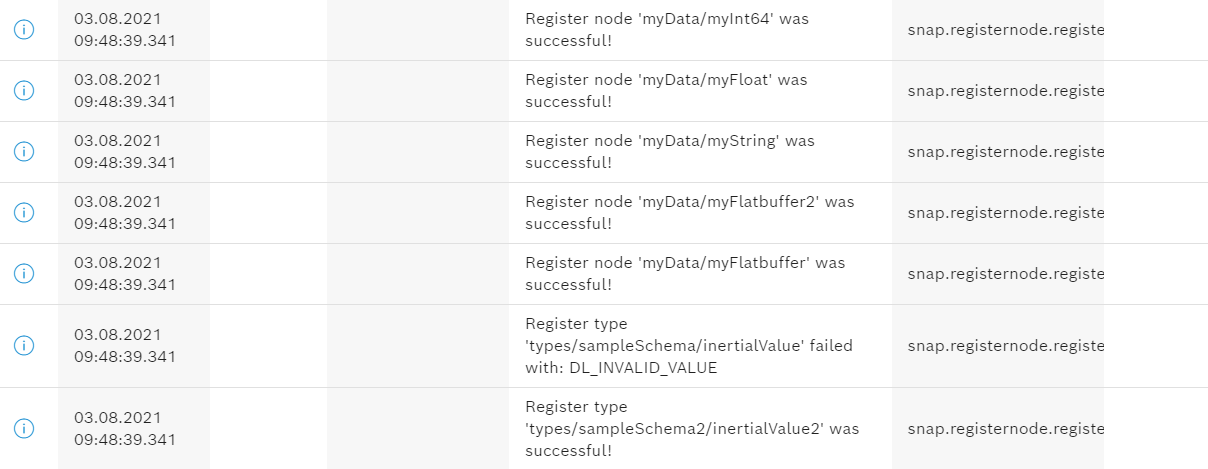

If I call registerType for sampleScheme2.fbs first, than sampleScheme.fbs returns "DL_INVALID_VALUE" when calling registerType.

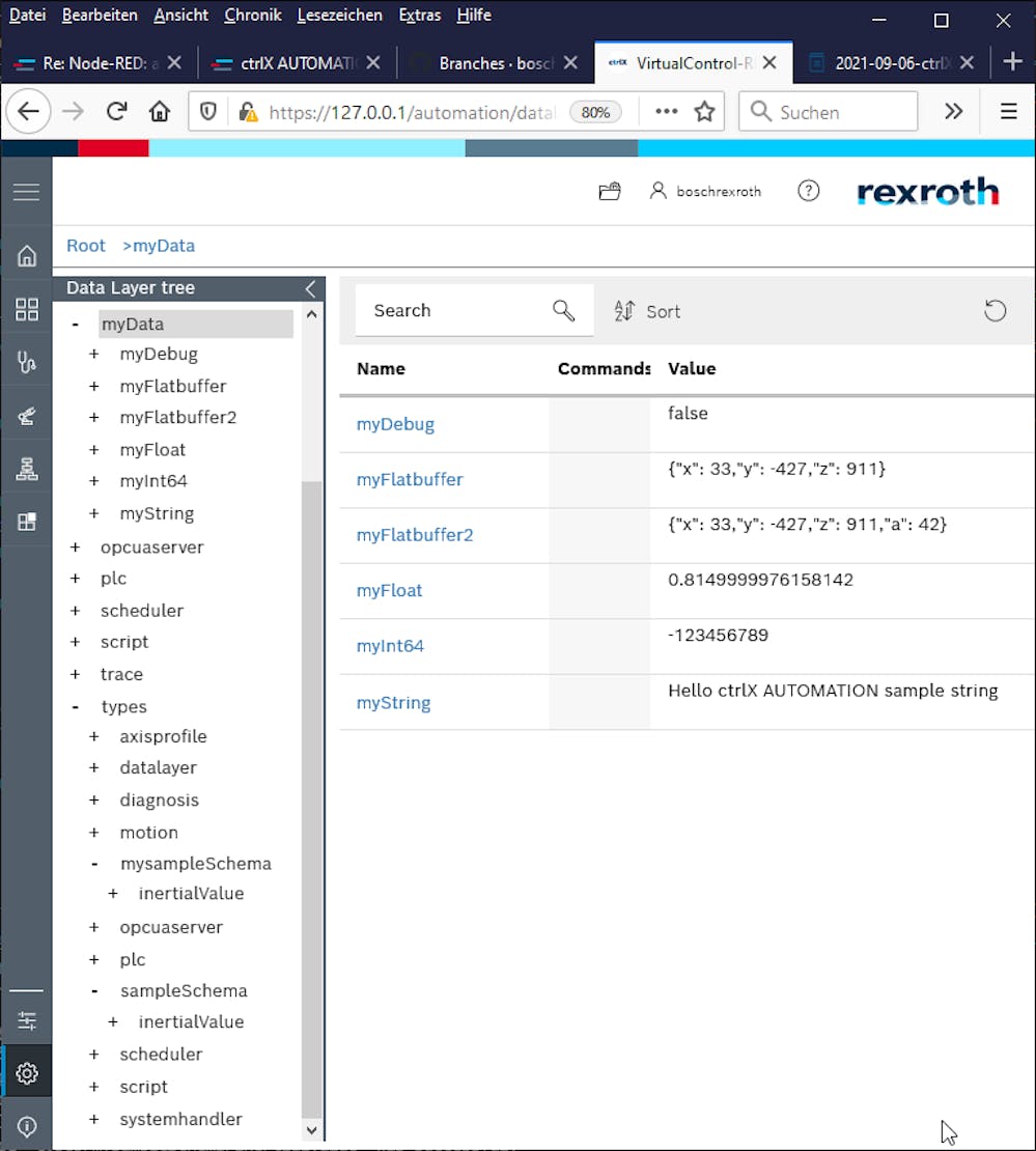

  4. Run application:
75.56KB
73.08KB
