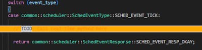

I'm using the scheduler rt example as a basis for my program and in this moment I have one cycle running with 2ms cycle time in this part of the code:
In addiction to this, I have another cycle (non real time) running in the finalStateMachine. When the state is on SCHED_OPERATING, my cycle runs. So far so good and the code runs well.
