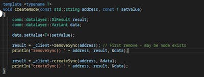

i try to create/add a node into the datalayer. I run an vritual-device out fo XWorks (ubuntu 20), and play aorund with the data-layer samples (C++)...
I could successfully connect to the device with the "DataLayerClient" sample , and successfully ping the device.
i worte a generic fun to create nodes :
but when i want to add (removeSync/createSync) a ne node the the dataLayer i get the "DL_INVALID_ADDRESS".
Do i have wrong charakters in the node path , or what are the issue?
