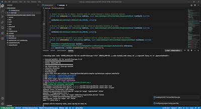

I'm trying to create the sample-snap "datalayer.register.node" for CtrlX Core. But it fails.

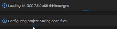

After switching cmake compiler to GCC 7.5.0 aarch64-linux-gnu message "Loading kit GCC 7.5.0 aarch64-linux-gnu" didn't disappears and building process failed.
Also this message didn't disappears.
If I create the snap for CtrlX virtual Core (GCC 7.5.0. x86_64-linux-gnu), building process works fine and the snap(app) is running without any problems on a virtual Core.
I think there is something wrong with the cmake cross compiler?!

While setup the SDK via WSL I obviously missed sudo apt-get install libssl-dev:arm64 🙈.
Now build process and snap is running without problems.
I have deleted the folders ( build, generated, ...).
But the messages still do not want to disappear.
How can I start a Cmake clean all in VScode?
Thanks for your suggestion.
