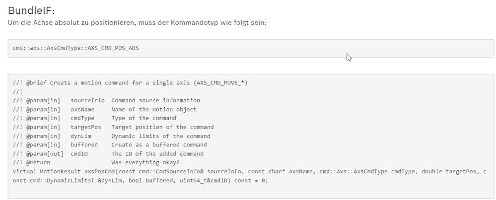

Actually, this is what I want to try (axsPosCmd is just an example):
I searched for this in the SDK and came across this:

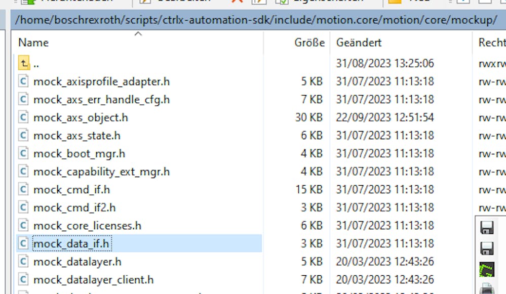

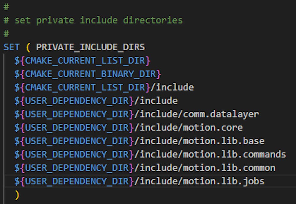

I am not sure if the mockup folders should be the "interface" for a user app. When including the mock_axs_object.h (this one seemed interesting to me for a start), I had to add more include paths:
However, I failed due to non-existent headers with obvious kinematics reference, which I cannot find in the SDK:
