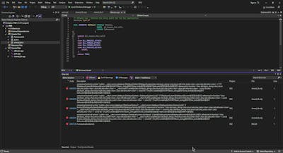

I have also tried it with visual studio on windows but I was stopped by getting an unusual error.

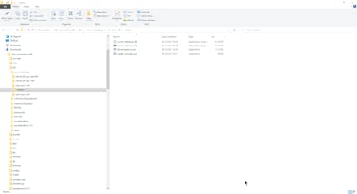

I want to build DLL something like in the picture below but based on my own functions.

problem was that I have run the code in debug mode and all the dependencies were in a release.
I have attached a solution file of the visual studio project with an executable below.
