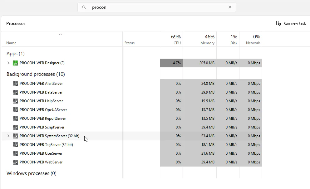

To fix this we need to first search in the Windows Task Manager for 'procon' and then end the 'PROCON-WEB SystemServer' task.
Then we modify the port forwarding settings of our virtual core to include '16620:16620,16810:16810,16800:16800'.
Now connection to the core should be possible.
