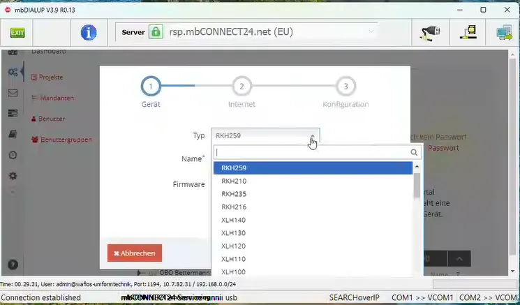

I cannot find the VPN-Client device inside the MBConnect DIALUP tool - as mention in this How-to. How can I set the connection using VPN-Client app?

A reply from MB Connect support:
A license is required for the standard VPN client.
If the customer has their own server, a test license is included. For accounts on the public portals, however, the corresponding license must be purchased and activated.
Please refer to "Number of standard VPN client" here:
 https://mbconnectline.com/mbconnect24-en/
Individual Features:
7.100.004.00.00     Standard VPN clients     +10 pieces     max. 50
