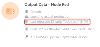

I have connected to OEE.Ai by using example node-red include of in GitLab.
At the Node-red:
OEE node has already connected status.
At the OEE's Sensor:
I can view data counting from client side.

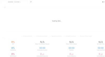

how ever, there is no data visualize in Machine/Measurements.

I can see from your first screenshot that the data being sent is for November 2022, but the chart in your third screenshot is showing February 2023. When sending measurements to oee.ai, please make sure the timestamps are for the desired period and in UTC.
The Node-RED example flow does not explicitly set the timstamp, but uses the current time. Please check that the Bosch CtrlX CORE clock is set up correcty, or set the timestamp in msg.to manually according to the documentation.
