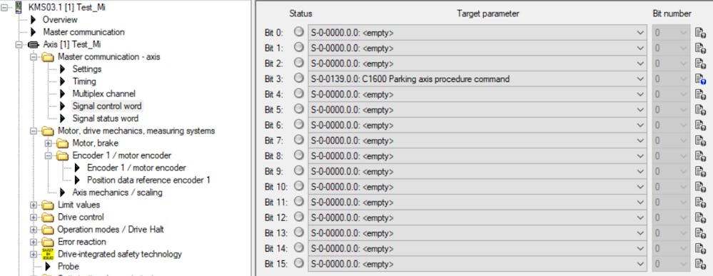

I want to unpark an indradrive Mi from Plc program.
Unpark is available via the command C1700 : FP_P_0_0139_0_150 .
1) IL_ECATSoeCommand doesn't supports this command.
2) I can't configure FP_P_0_0139_0_150 inside S145
Could you please give to me a workaround.
Many thanks
Best reply by Drives_Uwe
It is only possible to use S-0-0139 in signal control word, see:
