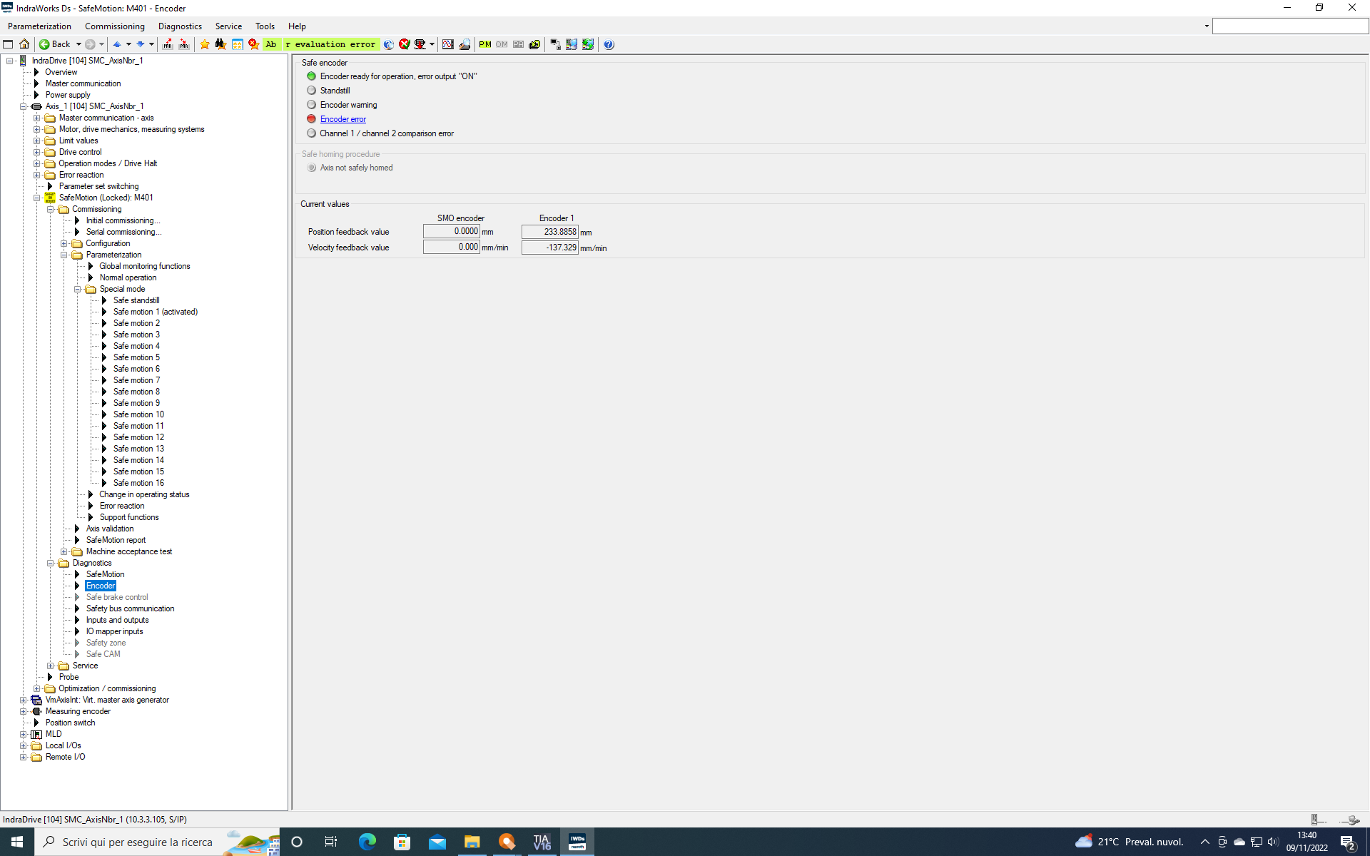

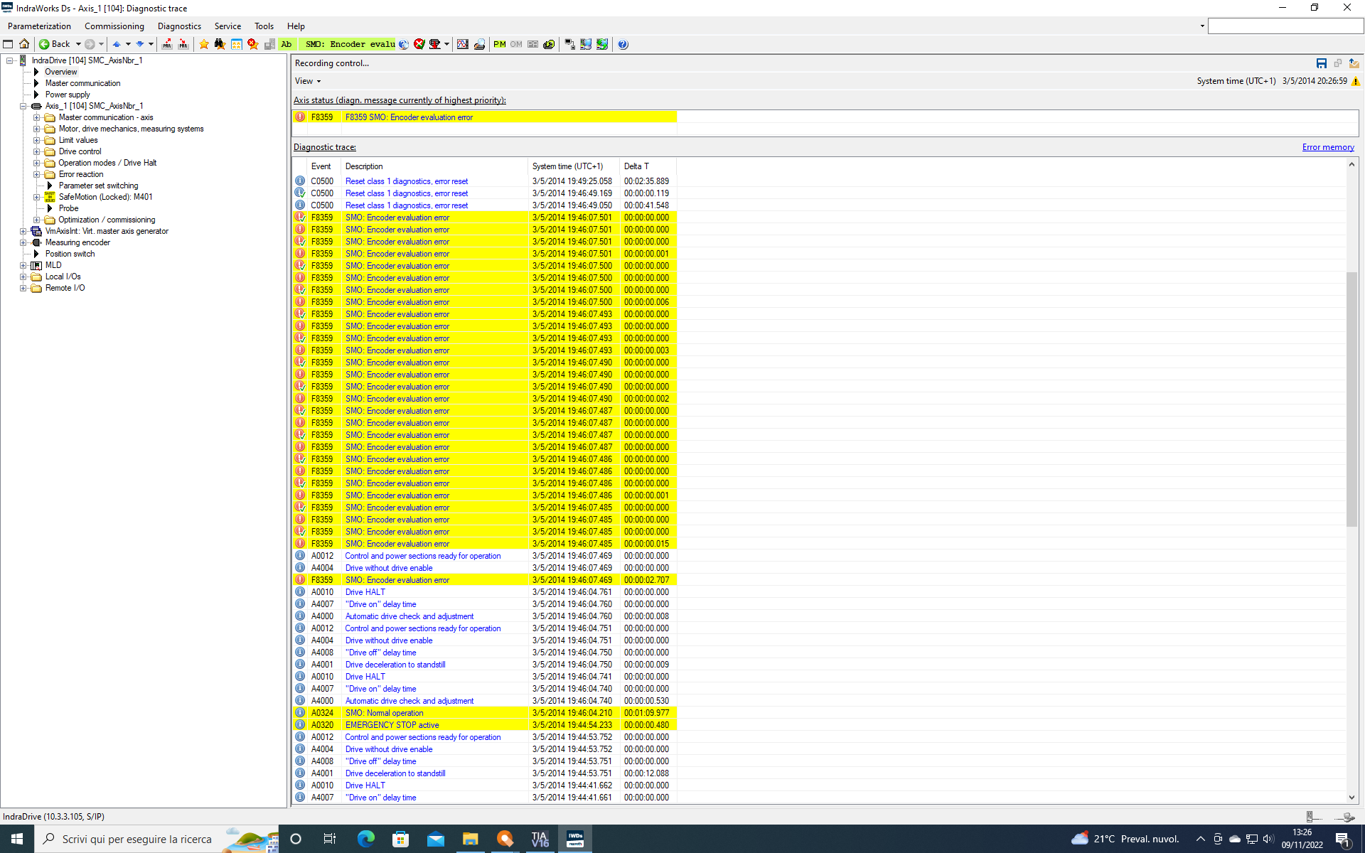

suddenly after some months that the machine is working correctly, few times per day the drive has the error F8359. In the drive there is active the profisafe with STO. The error doesn't reset if you don't switch off and on the drive. Are there any parameters that i can check or modify?

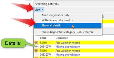

Best reply by StefanAT_ctrlX
You can switch to details. Maybe xou can add here the Erro-Detail:
